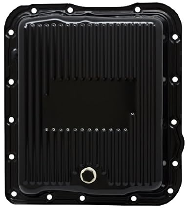

Dorman sells replacement transmission pans with the plug already installed for many GM vehicles.
Sweetness! Like this?
http://www.amazon.com/Chevy-700R4-4L60E-..._sim_sbs_auto_6
I believe I have a 4L60E trans. 93 4.3 Auto

That would be a great option if it's affordable. Just verify whether there were deep and shallow pan options on your trans, and which one you have. The Rockauto website can be good for that sort of information.
You take your pan off, and bring it to a welder. Pay the welder to weld on a "bung." Put the drain bolt in that bung, and you have a transmission that can be drained by removing the bolt.
Some companies make special transmission pans that are redesigned for better cooling, extra capacity, and happen to have a drain plug. Mag Hytec is the first company that comes to my mind.
