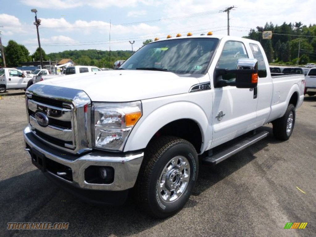

Did you ever figure out what was wrong with the driver door? In the picture you previously posted, it didn't fit right on the bottom. Maybe it has been in an accident like JHZR2 said. Not everything gets reported to Carfax.
The drivers door in this picture? Looks good to me.

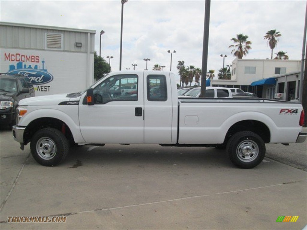

Look at the right-bottom corner of the drivers door, and compare alignment to these other 2015's:

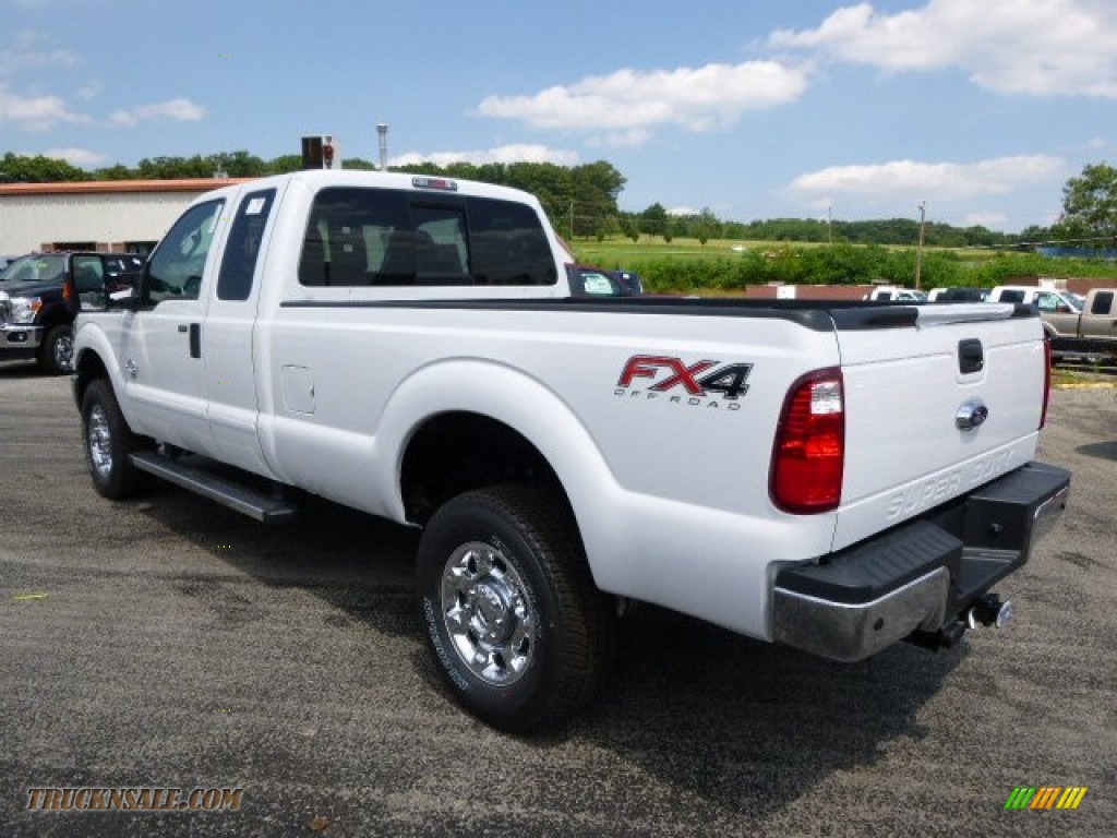

Donald, the bottom of your drivers door is sticking out, and isn't lined up correctly. Here, I cropped your photos.
