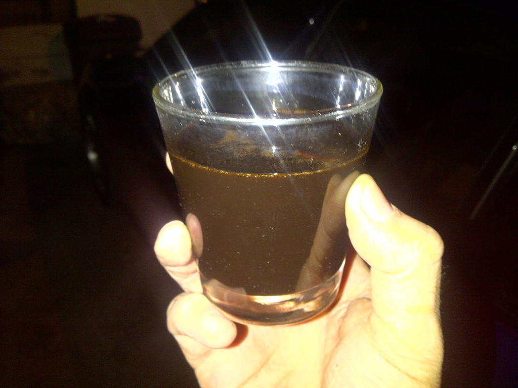

Honda Z1 ATF from my MIL's '01 Odyssey with a failing tranny:
That's still good right?
That's why our Honda doesn't use Z1 ATF anymore. It's doing quite well on Maxlife ATF. Couldn't tell the used Maxlife from the new I put in today after running 9k miles on the old stuff.
Wow, that looks like the "oil" I found in the bottom end of my 30 year old 4hp rototiller, you just need to mix in some water. Of course the tiller still runs like new even after that abuse, Odyssey not so much!
The "slurry" portion seems to have settled to the bottom of the drain pan. I was hoping to catch some of the metal (there is a LOT of metal) in the glass as well. I'll grab another sample when I drain it out into bottles for disposal.

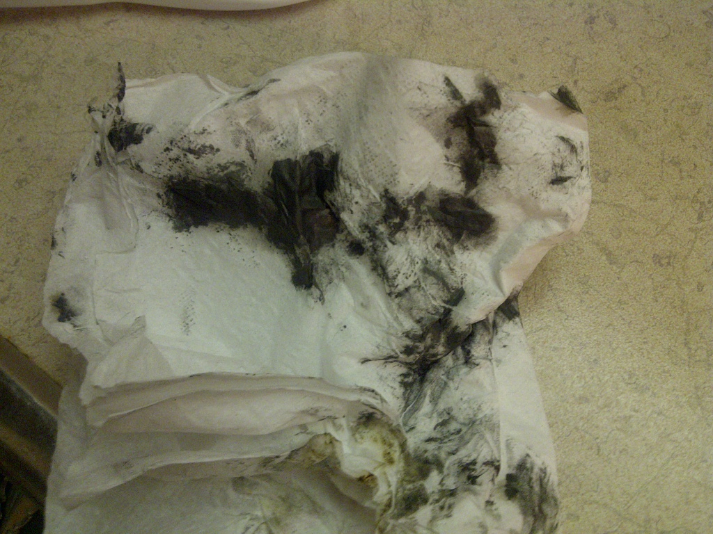

OK, couldn't wait. Just "disposed" of the oil. Here are the pics:
1. The rag I used to wipe off the drain plug earlier AFTER washing the grease/oil/metal mixture off with Dawn:
2. You can see the metal.....

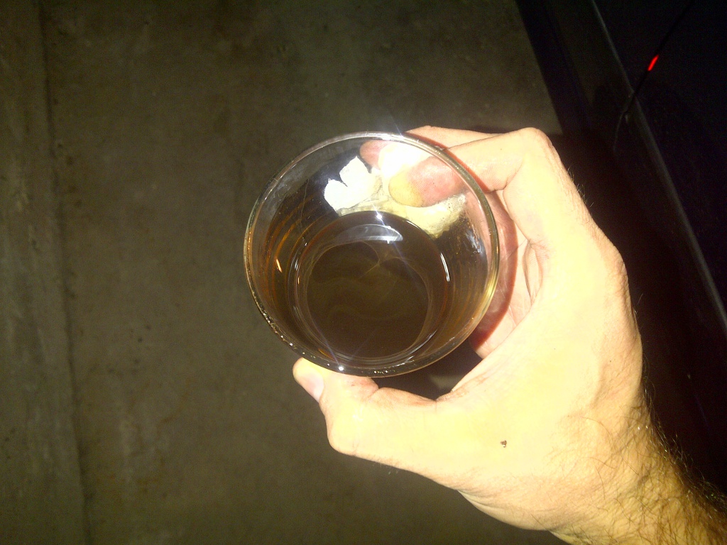

3. That's supposed to be in there right?
