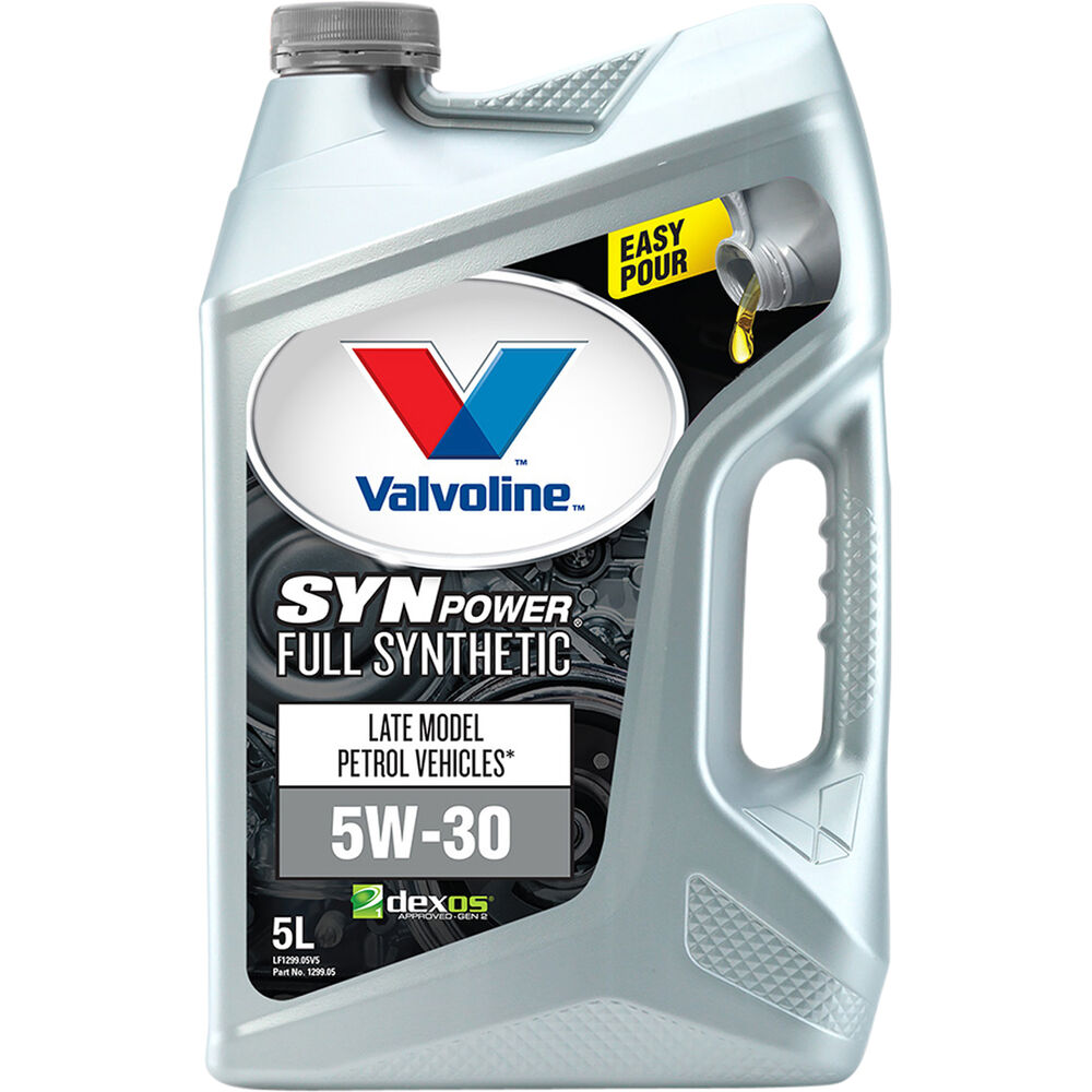

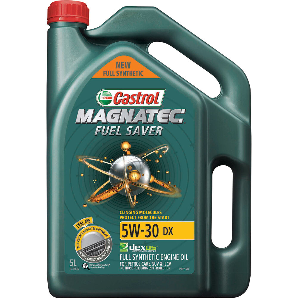

Sorry to revive an old thread but I did see this oil the other day and wondered if it would be a good candidate for the 1.5ltr 3cyl ecoboost...as wss-m2c948-b is annoying to find in Aus..(yes I'm not a Penrite fan lol)
On a small turbo engine I'd be looking for something that carries the API SN+ or SP category or GM Dexos1gen2 to help prevent LSPI.
Out of what would be available down under, I recommend these 2 oils
https://www.supercheapauto.com.au/p...03#prefn1=viscosity&prefv1=5w30&sz=60&start=7
https://www.supercheapauto.com.au/p...3#prefn1=viscosity&prefv1=5w30&sz=60&start=48
The magnatec should be API SP/ ILSAC GF-6A and carries Ford WSS-M2C946-B1 Meets and WSS-M2C961-A1 which are the 5W30 equivalents to wss-m2c948-b, The valvoline still only reflects API SN+/ILSAC GF-5 and ford WSS-M2C946-B1 but either or should be fine.
