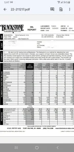

Here is the latest sample. No I have not done the GC test and I did confirm that Blackstone does not. I sent an inquiry to the lab suggested and have not received my sample containers in the mail yet. I'm wondering if an additive is gonna need to be a must to thicken that oil up some.
Thoughts?

I would say because your flashpoint still is pretty good it’s not fuel, but shear going on, and you need something with better shear stability. The viscosity isnt terrible if it truly has 16,000 miles on the oil.
Truly has 16k miles? How much should it have?
As noted Blackstone has a history of not being able to accurately measure things, especially flash point.

I was going off your previous samples of 3-5K miles compared to the one with 16K
Those we're either samples for new engine intervals, or other issues and the last prior to this was a draw from the dipstick tube. I've had a good bit of oil issues with this engine since new. I'm starting to think I need a heavier oil, or an additive. Something needs to stop this shearing.
