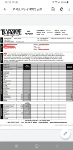

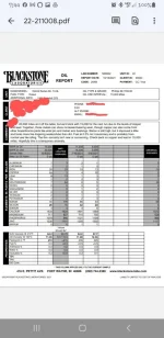

So here is the latest sample and a virgin sample..
Now the virgin sample I'm not sold by. I didn't witness the sample being taken from the tanker, I only aided in removing it from their sample container. I want to know what was in my buckets I returned and they're claiming they sent their own sample of that. I'm finding it hard to believe that my engine is breaking down virgin oil that fast. Idk what would cause that.
I've since filled the engine back up with 15w40 Chevron. I'm having trust issues with my local Phillips/Kendall provider after all of this.
I spoke to Phillips this past week as well as my local provider. Seems that no one knows why the oil is breaking down. They're saying it's fuel dilution and that Blackstone needs to do some other type of fuel dilution test, anyone heard of that? Also, all the virgin samples came back with good viscosity levels 14-15.
Lastly, the engines had Chevron in it for about 4k miles. Ok doing a sample today from the sump, the oil pressure has been better, oil temps are lower, and all around the engine just sounds better. I do get a little Huff out of the blowby tube. Otherwise it's better. I maybe sticking with Chevron or Ursa.b
Send it to Polaris or wear check they use GC for fuel it’s very accurate
The only way to fuel to get into the oil other than past the rings that I know of are through the top of the injector through the plunger or the o ring(s), a cracked head (unlikely) or the fuel pump leaking into the back of the air compressor. Do you notice your oil level rising? The low(er) flashpoint does indicate fuel present, and it’s likely more than what black stone is reporting
No, the oil level isn't rising, there is nothing to indicate any type of fuel dilution. Evey sample I've taken has had >.5 dilution.
What is GC? Is that the other test that Phillips is talking about?
