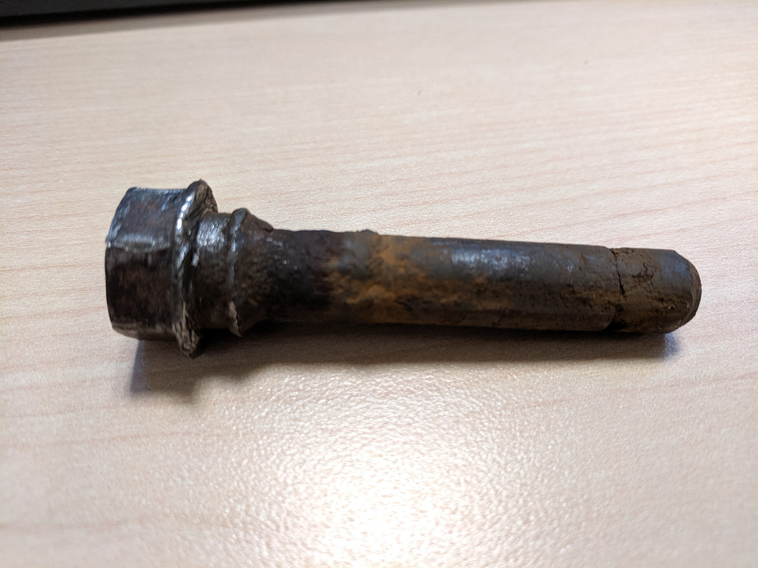

The front is what surprised me the most, at 66K there was no way they were the original front pads but the slider pins were very seized up. One in particular was completely stuck in place. Usually a few taps with a chisel and hammer gets it out for me, but got nowhere with that. A 22" long 1/2" drive breaker bar would not move it. Had to use an air impact to get it to eventually rotate, and what finally persuaded it to come out was attaching an adjustable wrench to it and whacking it with a 4 lb sledge hammer over and over and over.
Here she is:
The pin itself does not have the rubber bushing on it, in its place is just caked on rusty grime. There was a bushing inside the bore that I had to fish out. So ultimately, my guess is the last person that did the front pads pulled the pin out and the bushing was stuck in the bore, and they likely replaced the pin with no bushing, with it unknowingly sitting beneath it. Whatever happened, that pin was not moving the slightest.
It makes me wonder how many out there have something going on with their brakes and don't realize it. Based on my cars prior brake performance, I would not have guessed this was going on. It seemed to stop fine, but it is way, way better now. Stops like a brand new car. I wish I had done this as soon as I bought it. The only other time I had a pin very seized is when I had used the purple Permatex stuff, which I found later to swell bushings and dry up rather quickly. It was nowhere near this stuck though.
Here she is:
![[Linked Image] [Linked Image]](https://i.postimg.cc/5tCbQHPV/IMG-20190708-075400.jpg)
