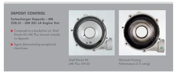

for some reason, group of people like to buy "magic dust in a can".
they pour it to intake, exhaust, and oilpan (who knows elsewhere)...
sometimes it helps, sometimes not... and there is this thing called placebo effect. lol
as the document says, hdeo cleans also the intake side of turbo. i expect it should help with some ivd stuff...
continuous cleaning during the entire oci, makes more sense to me, than just 10minute miracle in a can....;)
https://certasenergylubricants.com/...shell-rimula-r6-lme-plus_product-brochure.pdf
It's not really magic or even snake oil. Ever heard of an air/fuel induction service? That's pretty much what you're doing spraying seafoam into the intake.
Nothing is going to remove intake valve deposits from a GDI engine except going straight into the intake. Oil, fuel treatments etc have no effect on them. If anything, hdeo could (over time) make IVDs worse due to the high SA content.
