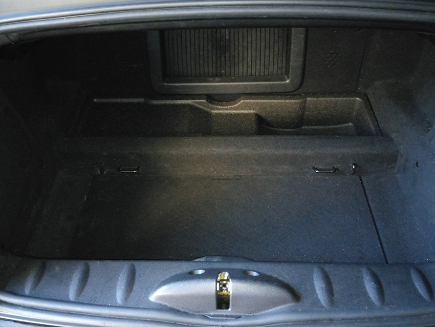

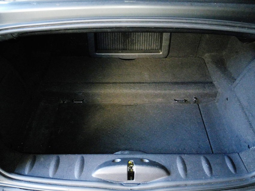

This is the trunk space I have to work with. There is a total of six tie-down anchors. I can get a full-size spare in there but I'll lose much of the cargo space.
Whole trunk

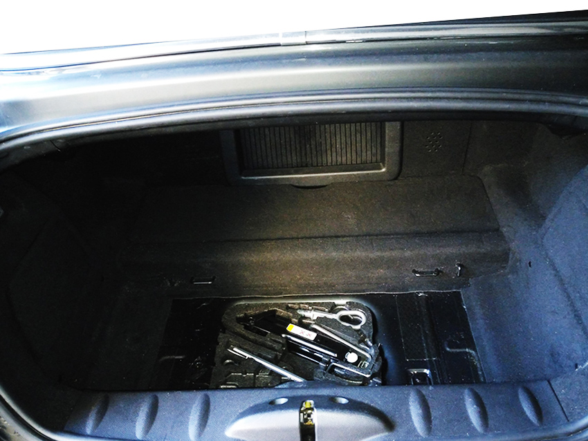

Large cubby with wheel change kit:

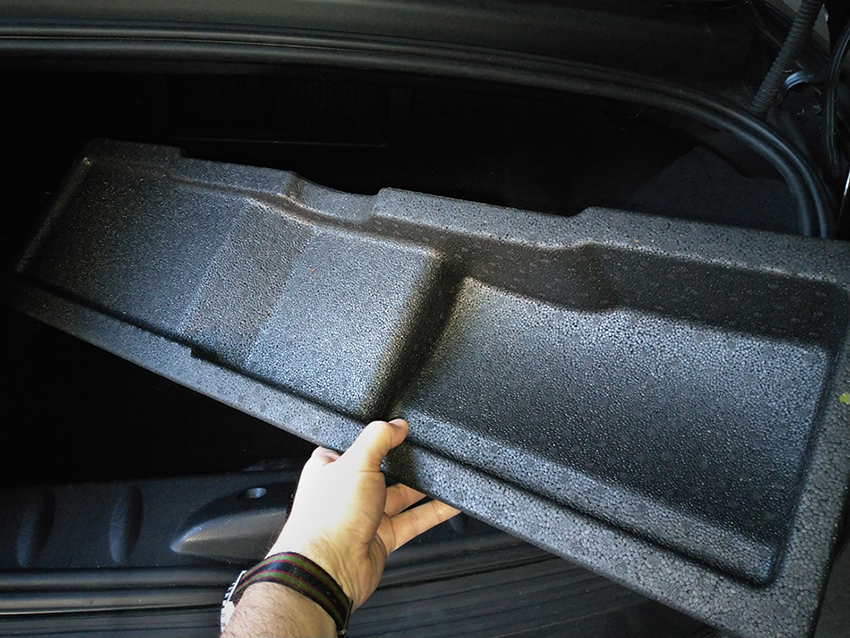

Small cubby:
Small cubby tray removed
