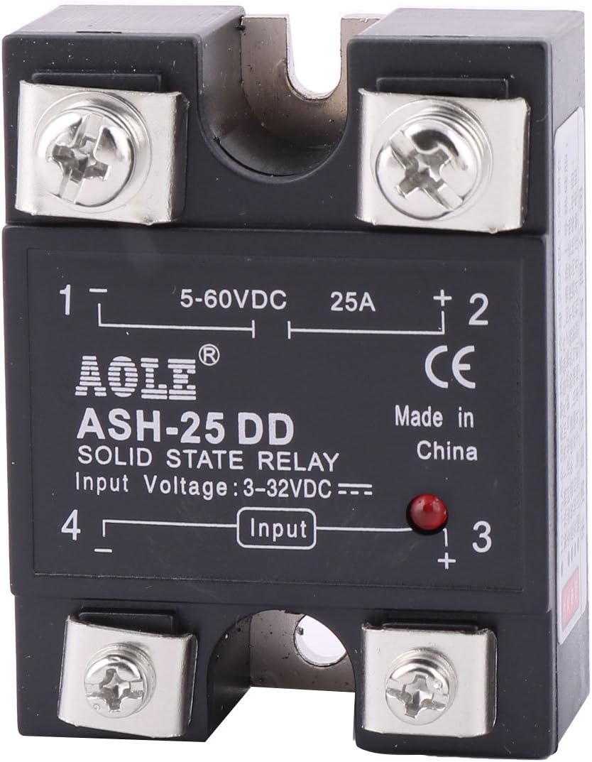

I am confused by one thing on this wiring and want to be sure that I have it correct. One of the Jeep forums that I am on posted a nice write-up of how to wire the side-step lighting, I translated the wiring connection text into a picture using the schematics of the AOLE ASH-DD25 relay.
When the relay is energized, how do terminals #1 and #2 connect to one another to pass 12v to the lights? It is confusing, since it seems that terminal #1 and terminal #4 would be pass through once the relay is energized as would terminal #3 and terminal #2.
What am I missing here or will this work?

Yes; it is a solid state relay. The confusing part for me is there is a positive and negative terminal on each side of the relay. The left side (control side) makes perfect sense, it is the right (load side) that has me scratching my head. Since terminal #1 is denoted as negative, it did not make sense to me that it would make a connection with terminal #2 which is denoted as positive because that would seem to create a short circuit would it not?

What the drawing has labelled as "load" would be your lights. The arrow that you show for 12 volt positive to lights should be drawn pointing to the side of the load (lights) that is labelled 1. The statement "#1 + Red wire going to your lights" is correct, but your arrow points to the negative side of the load, not to #1. It is not a short circuit because the load is between the positive and negative terminals.
The LED biases the transistor allowing it to "turn on" or allowing the current to flow. If the polarity was reversed, there would be no current flow.
I figured it out with the aid of a 12v DC power supply and my trusty volt/ohm meter. Terminals #3 and #4 (control side) do not pass any voltage to terminals #1 and #2 (load side). When the control side is energized, there is a circuit created between terminals #1 and #2. Question answered and now to wire it all up.

The #1 terminal is marked as negative both on the schematic I posted and the actual relay as shown below and I am pointing to terminal 1 in my annotated schematic for positive to the lights. Look again at the schematic and you will see the "1" to the left of the minus sign for terminal 1.

See my post above, I figured it out. Basically when power is applied to terminals #3 and #4, terminals #1 and #2 are a switch that is closed making a circuit so the power from the battery attached to terminal #2 can flow to the lights attached to terminal #1.

So you get trigger power to terminal 3 it is then grounded on 4
on the other side the incoming battery is 2 when 3 is powered it connects 2 to 1 which is connected to the lights positive (despite having a negative sign next to it)

#1 is the load which has a path to ground through the component being powered. Amperage flow matters with a Transistor.

Some of the solid state relays do not support ac current. The load side is dc only, and current is only allowed to flow one way--if you hook it up backwards they are likely to flow current through a diode and the load will be stuck on. They do that because if they used two MOSFET's in series as a transmission gate then they increase the on resistance, and in many DC circuits that just isn't needed.
A solid state relay shouldn't wear out--no moving parts to get corroded with time, carboned over from arcing, and no wear points. They might switch on faster (might not be of interest for lighting). But anything can break... They can often have lower power required to actuate, the standard 12V auto relay is something like 100mA for the coil (quick look at a Panasonic CB1). Also they are current driven devices and as such can be switched on / controlled by something other than 12V, and that controlling device doesn't have to worry about inductive loads.
