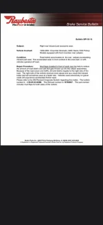

On my 2004 Silverado I’ve put three sets of rear pads and rotors on (always the right inside pad worn down to nothing) to the one set of front brakes. The front outside pads are still like brand new but the inside face of the rotors are chewed up pretty bad now from salt/rust so the inside pads are actually starting to wear haha. Gm actually came out with a bulletin for the rear disc brakes stating to put a mud flap kit in front of the rear wheels to keep debris and salt and all that crap from eating that pad down to nothing. I put that kit on the last time I changed the rear brakes and they seem to keep a decent amount of the road debris off the inside pads but aren’t perfect.
Yep we had an '02 Silverado that always had rear brake problems and ditto for our '05 Yukon. GM briefly threw in the towel around '05 on the pickups and returned to rear drums.
