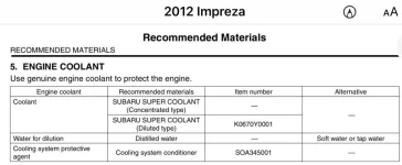

I did a radiator drain and fill at 100K to freshen everything up and then a full coolant flush at 135K. Everything was good but the car started consuming coolant after the flush. I added a bottle of “Subaru Coolant Conditioner” and that stopped the consumption completely.
Before people flame me for using a coolant additive. My factory service manual has “Subaru coolant conditioner” recommended at every coolant change. Despite me confirming with the dealer that they were going to put in “Subaru coolant conditioner” they instead put in “BG coolant conditioner”. The car almost immediately started consuming coolant (3-6 fl ozs, every 500 miles or so). I added the factory recommended conditioner and went for a good long drive. Zero consumption 8K later.
