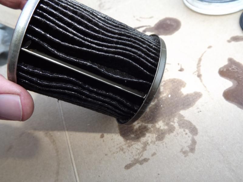

Here is a Puro Classic l4610 that was run for around 4400 miles. This is a customer's 2002 Civic with 213k miles that lost a head gasket recently. The owner added nearly a quart of Prolong during the OCI. It uses a little oil, and that was all he had available, I guess. There was also about a quart of coolant passed to the oil over the last 2000 miles of the OCI. Sludge had started to form in the engine, and the varnish has gotten darker during the OCI as well. VWB 5w-30 No tears, but wavy media with thickened oil residue in the can. F06E14E2 date code.
A little wavy, but still structurally intact. Im starting to think that a vehicles age (in miles) and overall health has a lot to do with Purolator filters do throughout the service interval.
^^^ To add/clarify - media tearing does occur even on filters used on low mileage pristine engines, and well below 5K miles of use, so can't really equate Purolator failures to "abused" filters. But yeah, any time there is a lot of condensation (from many short trips), or a coolant leak like in this case, then the pleats will be pretty wavy. Same would probably hold true with any cellulose based media filter.

^^^ Except media tearing does occur even on filters used on low mileage pristine engines. But yeah, any time there is a lot of condensation (from many short trips) or a coolant leak like in this case, then the pleats will be pretty wavy. Same would probably hold true with any cellulose based media filter.

Typical of someone looking to derail a conversation. If you look closely, I made the comment that the vehicle's age (as in miles on the engine) and the vehicle's overall health may have great effect on the filters outcome (as in waves, tears etc.) Go trolling in another thread
Yeah, so did I. But in this case, if it was gonna tear it would have done it way before 4400 miles and it would have done it if the engine was brand new. grin

jk's point is that there are no issues with tears in this Purolator example under a pretty severe service condition. But the post by Z0 steers the discussion straight to this point. The result, whether intended by Z0 or not, is to undermine the good performance by the filter by using the Purolator tear "strawman" again, and again, and again, ad nauseam. If this were the only example of this, I'm sure jk would have been a little more understanding. To the OP, thanks for cutting the filter and posting the pics.
