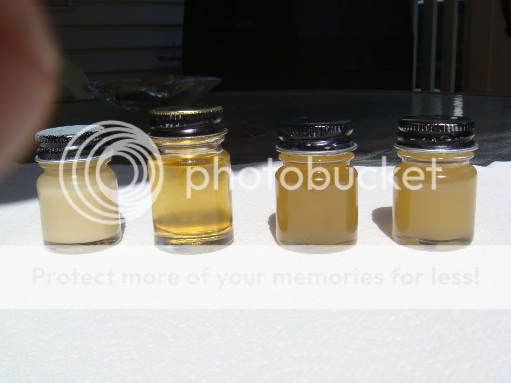

One more test:
The procedure I use is to take 6 tablespoons of talcum powder (which is typically about 10 microns according to the Filter Council pdf webpage) and mix it into about a pint of fresh 5W-20.
1. Clean and dry my test bottles and eye-dropper inside and out.
2. Submerge the clean filter element into the talc/oil and draw samples from the center tube.
3. Re-stir the talc/oil, rinse out my eyedropper in clean oil, and repeat with the second clean element.
4. Cap and re-clean and dry the outside of the test bottles as needed.
5. Agitate test bottles all the same and let set to raise any air bubbles.
6. I use sunlight to examine and photograph the relative clarity of the filtered oil next to
a clean oil sample and an unfiltered oil/talc sample.
Left to right, unfiltered talc/oil mix. Clean oil from same source,
old style PureOne sample, new style PureOne sample.
It appears that the old, relatively slow flowing PureOne has a slight edge in filtering these very fine particles—but it is still one of the best results I’ve seen from an oil filter in testing this way.
Hmmm it should be better,did you run it twice?? good test!
move the jars father away the (white)shadow is carrying over to the next jar it looks like..

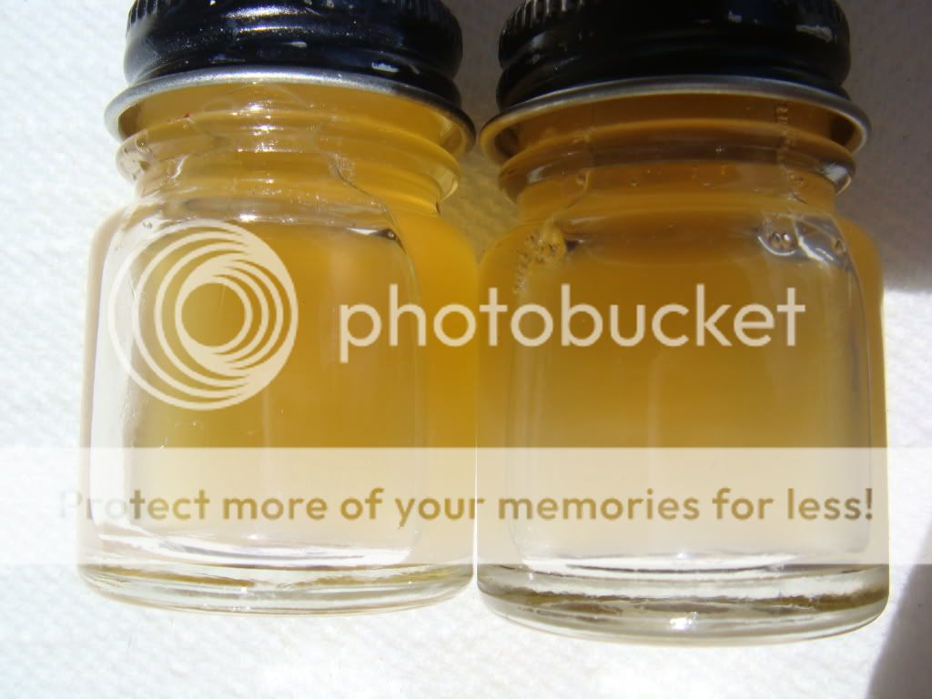

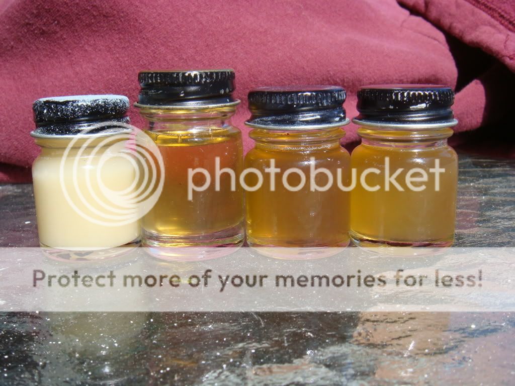

OK. I think I know what happened. I don't usually test two elements right after each other, and as you can see by the filtered results, the mixture, and so the filtrate gets progressively more concentrated if I'm not careful.
When I lifted the first element out of the mixture, I let it drain back and the white sludge runs back into the mix can while the thin oil stays mostly in the paper.
This time I tested the same way, (but opposite filter order) only without draining back into the can.
Now I can't really see any difference between the two filters. I can only see that since the mixrue is cloudier than the first test, so is the filtered oil. The filters only ever catch a percentage of my brew, so I have to be careful to keep the mixure as constant as possible:
In each case the new style PureOne sample is on the right.
Ya. Same as far as I can tell in person with the samples.
The new style is rated at 99.9% eff. @ 20 microns, and the old one @ 98% efficiency but it's a little vague on microns.
Anyway, visually, there's no way I could tell the difference when two ratings are that close.
It does seem to flow and clear up the oil very well though--and this is just one pass of oil so contaminated it looks like house paint.
I've tested a bunch of filters this way, and seen a lot cloudier oil get through.
I'd say the new PureOne passes my little tests really well.
