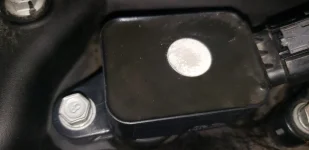

The TSB says if the coils are the original type with white dots on top and no ribs on the mounting foot, they'll automatically put in four new ones if you complain of CEL coming on with a misfire code.
The OP's coils appear to have gray dots so that wouldn't apply.
Also since the engine was misfiring but not throwing a code you probably want the software update which addresses that.
The picture does make them look gray. I thought they were white so I went back and checked.
White and no ribs.
They also did a "software update recall" that was somehow related to knock issues, so that's probably what was done. It misfired AFTER the update also.

Well it went back to the dealer last week and it received new plugs. I tried for NGKs, but they ultimately didn't have to give me anything, so I accepted a new set of YURAs. I just said I'll keep a really, really close eye on them (and plan to check them again before the 60K mark. They also were nice enough to install a brand new set of 4 coil packs & boots as well, without a code present. They installed the updated white dot coils with the "ribs" (see CB900F2's TSB post). The ride home was flawless. It has been sitting for several days, but I took it out for it's first real drive today...80 miles round-trip. Once again, it was flawless. It drove like a brand new car. I'm 99.9% convinced this was my issue, and am confident closing this case. If I have any issues going forward, I'll report back.
