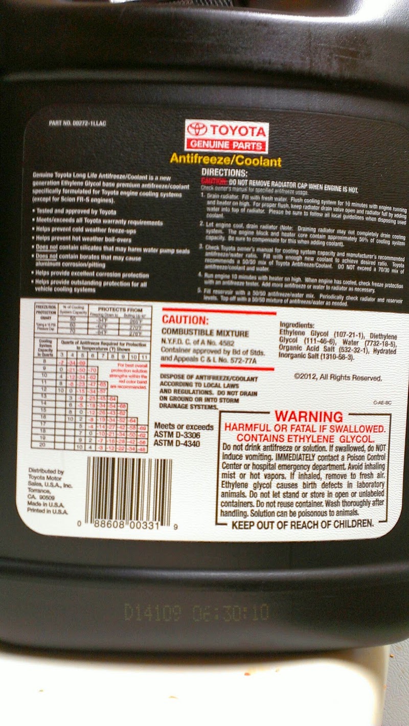

Picked up the Toyota Long Life Red antifreeze. Negotiated the price down to $23.82 + tax. It's basically a traditional (green-colored, even though it's red-colored) antifreeze without silicates, borates, nitrites, amines, 2-EHA, sebacic acid, and other OAT, but with beneficial phosphates and benzoate, and also with potassium hydroxide.
(However, traditional antifreeze also tends to have a low dose of silicate. G-05 antifreeze, which also has benzoate and no OAT is similar to the Toyota Red antifreeze. Unlike the Toyota Red, G-05 has a low dose of silicone but no phosphates. Phosphates are only bad if antifreeze is mixed with very hard tap water such as found in Europe.)

And how can it "basically" be a "traditional antifreeze" colored read instead of green, if contains NO silicates which is THE main inhibitor in traditional original green?
In reality, it's an older shorter life Asian PHOAT with all it's characteristics, that is now being superseded by the longer service interval Toyota Super Long Life pink. Also why red is now becoming much more expensive. Other than the short recommended service interval nothing like original green.
If one wanted a basically conventional green (which is still available) but newer, Zerex and some others now make a low silicated original green with a longer service interval less susceptible silicate drop out considerations.
But, not containing 2eha Toyota red is preferable to using the topic of this thread, Dexcool/dexclone.

Well, a bottle of domestic Prestone is $17, and we're talking about a dealer fluid made by a Japanese company (CCI). The list price is $30.48 and many dealers charge more than the list price for OEM parts.
The recommended interval for traditional coolant is 30k miles / 3 yr for my engine. This is long-life coolant; so, it should be about 45k miles / 3 yr.
Toyota/Honda don't allow silicates and they also require phosphates for water-pump protection. Most coolants out there have no phosphates.
In fact, the only aftermarket coolant that meets the Toyota/Honda specs is Pentosin Pentofrost A1 and it sells for $26.
Must have a different interval than my 01 Tacoma which came with LL Red and says 2years(24months)/30k mi. max right from the owner manual.
So LL Red has Phosphates ie., P-Hoat, and no silicates but is still "basically" a traditional green, which has no phosphates but has silicates?
Why be so argumentative?
My manual says 30k miles / 3 yr.
Depends what you mean by traditional. American antifreeze used phosphates, silicates, and benzoate commonly in the past. In that sense, for example, the HOAT with benzoate (such as G-05) is no different than traditional antifreeze of the past. Color of the antifreeze (green etc.) has little to do with its type or composition.
