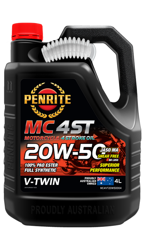

I generally don't look at motorcycle oils - the shared trans bikes get an HDEO of 15w40 or 30, the Airhead just needs a car oil. Although I'm a bit fussy with my 20w-50, a pushrod 2 valve twin needs a bit of ZDDP.
I also don't look at Harley oil. But a HD is an aircooled 2 vavle pushrod twin...the Airhead is a 180 degree V twin. So I got some Penrite V Twin 20W-50, on sale, down from outrageously expensive to just very expensive...well, down to cheaper than Edge. Just worried about oil leaks with the POA/ester. I have a slight pushrod tube leak, I don't really want it pushed to a repair job.
http://www.penriteoil.com.au/products/mc-4-v-twin-20w-50-100-pao-ester
