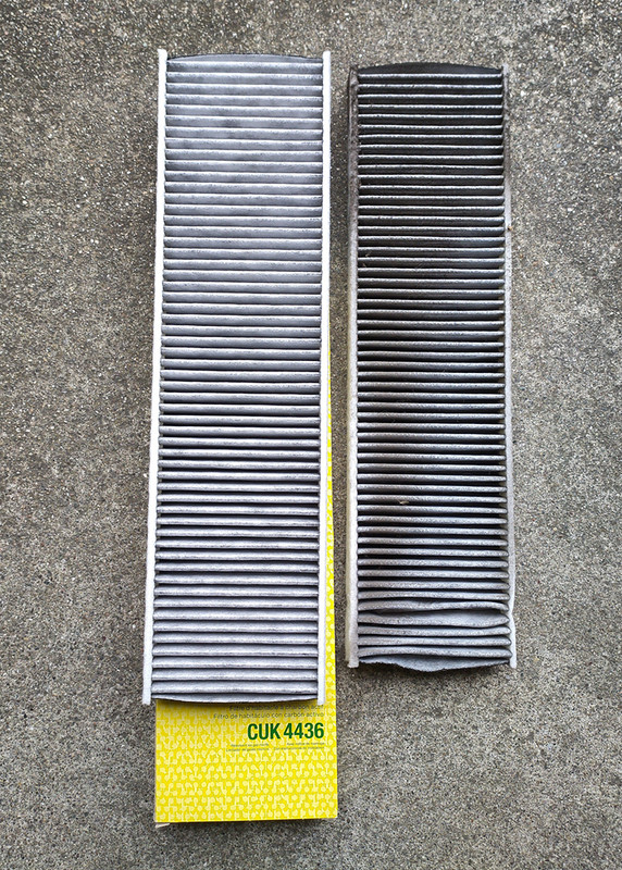

Miss Moneypenny got a new Hengst CAF this morning., Took 2 minutes. There's a hinged lid under the glovebox that's accessible from the passenger side footwell. The old filter slides easily out and the new one slides in with very little resistance. Not tools needed.
The new filter looks bigger than the old filter because it's closer to the lens than the old one. The old filter has over 20k miles on it and was in there for 14 months.

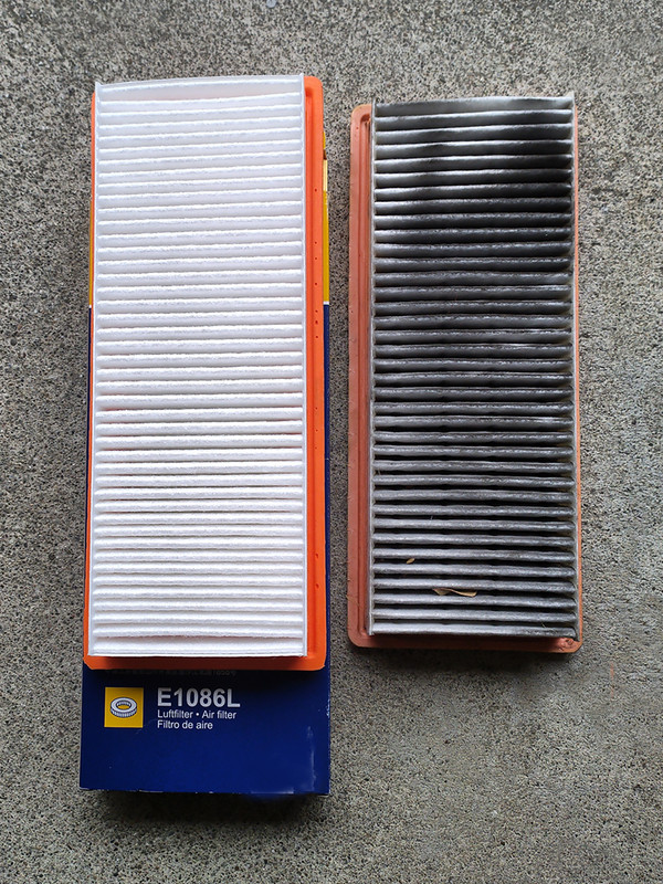

Today I replaced the EAF in the Mini. Very easy, barely an inconvenience. I had to loosen one slotted screw so I could pull the air intake snorkel off the air filter housing, I had to unclip the MAF sensor connector, and I had to loosen three T25 screws to open the air filter housing 3-minute job. I used a Hengst filter.
Like the CAF in my previous post, the EAF has over 20k miles on it and was last replaced 14 months ago.
