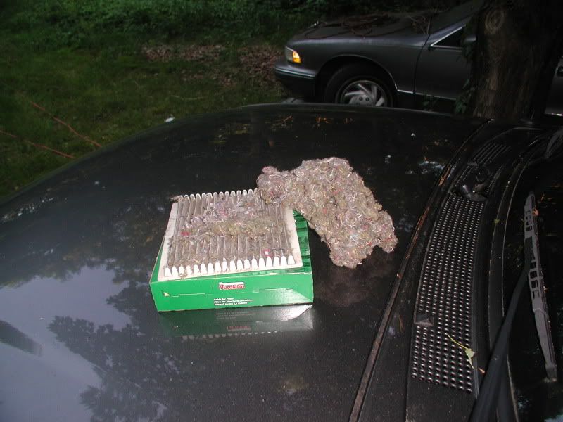

Something like this might be caught in the air duct.
I recently solved the same issue on my 97 Camaro. The blower fan was about half to 3/4 of the way full of packed down [censored], leaves and stuff. I had the dash completely appart and shop vac out everything. Blows like new now. Could be a blend door issue too, but I thought I'de share this.
well ill have everything apart so i should narrow it down whether its a blend door or packed full of leaves
evaporator was packed full of dirt leaves and hair, cleaned it all off and have perfect air flow now.

[img:right]
[/img]
Ugh. My daily beater Civic doesn't have an air cleaner filter though the non-USA market models did. My car has the slot for it, just no filter. I saw some DIY write-ups for it and will try next week...a little scared to see what that space looks like. Probably something like what you posted. Bleh.
