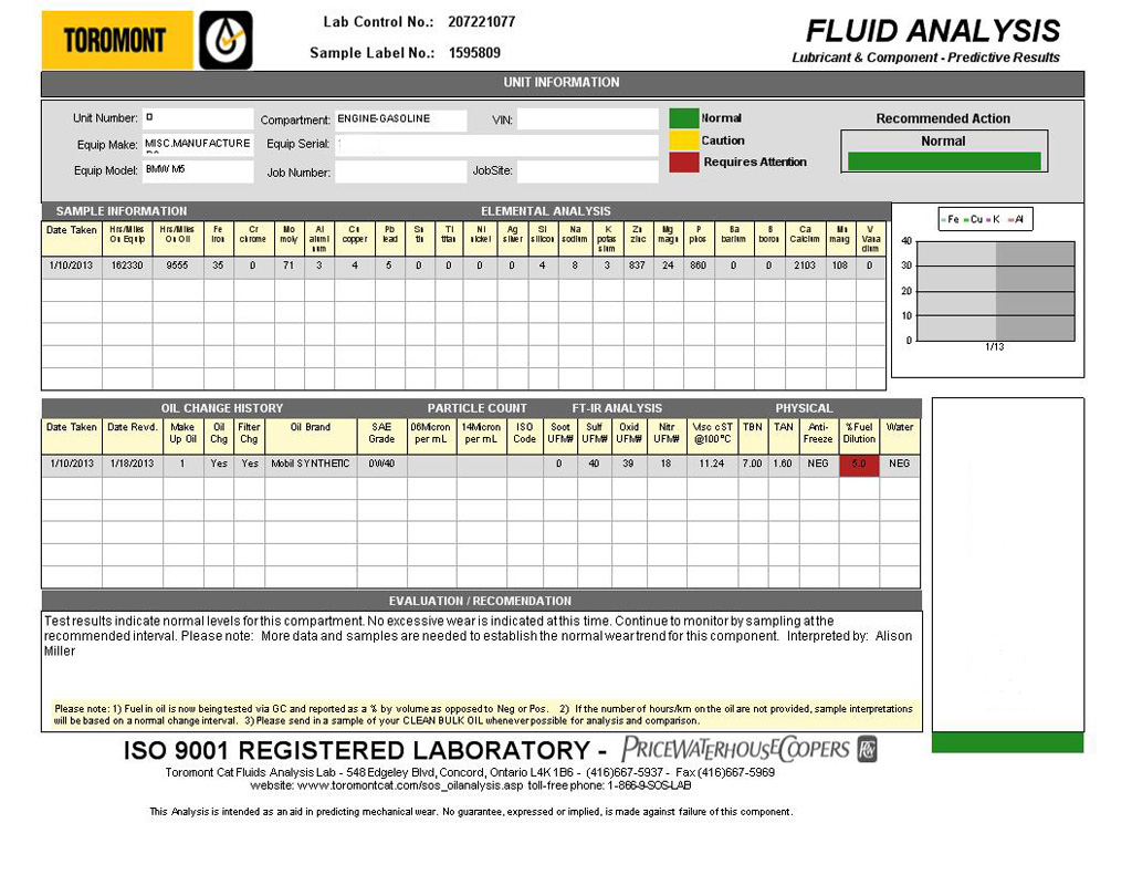

Fuel dilution........ How about 5%?
This was last January.
In some vehicles it can be a real issue. SteveSRT8's 300C also does a similar number on the oil.

What was the cause? Wasn't idling. Steve says he doesn't do that. Even more telling was the remarks, "...no excessive wear..."
It's already well established heating the oil up to normal temperature will NOT burn off fuel. If that report is from your vehicle I bet you changed the oil. Where is the problem? Where's the water in the oil?
My '11 CR-V has fuel of about 2% on every sample I sent in. Other than that, the engine appears to be not wearing at all. Where's the problem?

Certainly, I wasn't implying that wear was excessive or anything of that ilk. I don't idle the car much (it has heated seats that warm quickly), just usually for the time it takes the clear off the windows and the idle to settle.
The cause is the factory tune of the car. It has high compression and a relatively rich fuel map. Add that with cold winter operation where cold start enrichment is added to the mix and voila! We have 5% fuel, LOL
Yes, I changed the oil. And it was well before the OLM (which still hasn't gone off BTW) wanted me to.

The point of showing this report was simply to demonstrate that the potential for significant fuel dilution still exists in a fuel injected engine, particularly those of the high performance variety with richer fuel maps. You don't need a Holley Dominator to get a good dose of fuel in the oil
