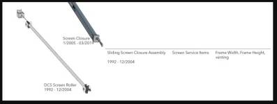

FYI ~ the part is called a DCS Screen Roller. The Customer Service rep at Pella referred to it as a Screen Roller Assembly. They have them in stock. Ordered myself one today. Hope this helps. View attachment 26093
I realize this is an older post but I have a Pella screen door with the same overhead assembly (1992 - 12/2004). My problem isn't the header but the screws that hold the screen door in place that fasten the door to that little black piece on the roller. What size screw is it? Pella has no idea what I'm talking about.
I have 6 Pella sliding patio doors. 5-6' and 1-5'. I have replace all of the DCS Screen rollers at least once. All made in 1996. I purchased them because I had Pella doors in the 70s and never had an issue with them. My question. Has anyone come up with anything different that will work? Has anyone tried the 03UY0002 rollers? l can't tell from the pictures if they would drop the door too much to work. Tired of paying over $200 for a part that probably doesn't cost Pella over $5 to make.

I joined this group to specifically provide an answer for what I feel is the correct part. After a LOT of effort on my part, I finally got ahold of a human being at pella, who told me this is the part I need. It is slightly different from the original, as it does not utilize a self closer. I was told the self closing style is no longer availible. You do not use the spring with this one. You will have to manually open and close the screen yourself. FYI, The part comes with screws that may or may not be long enough. In my case i simply uesed the original screwes. It comes also with two of the special plastice nuts, which was good, since one of my old ones was cracked. The part fits and now my door opens and closes with ease. I paid 65 bucks for it.

Hi - I've got the same issue with this 90s Pella Screen. I have not had any luck finding this part from Pella. They want appx $1K for new screen. I'd be happy to give up the self closing function, yet not finding the part number. If anyone has discovered a solution - please post!
Hey BTuck - please let me know if those printed parts worked? I'd be interested in purchasing. Here are some illustrations:
