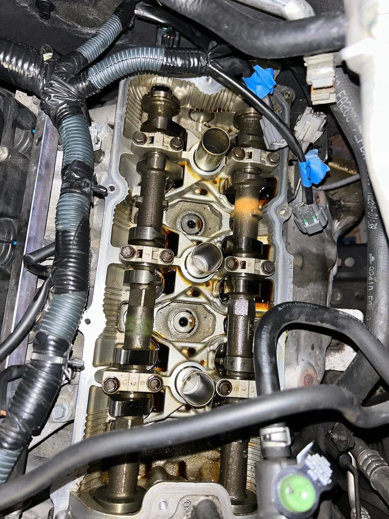

Kia Rio 2015 with odo 240k miles.
Fixed with only $45 by replacing valve cover gasket, and gaining an insights onto how healthy camshaft is (even though it was sludgy) the cam surfaces looked like mirror without scoring, i bit surprising at this mileage.
I thought it'd be a bigger money pit.
Turned out simpler than initially thought.
Kia seems to manufacture very low quality stuff when it comes to seals and gaskets

It's non synthetic oil (that's probably why it's bad)
Even with brand name conventional I would never expect this amount of sludge unless it was some high output turbo gdi engine which this isn't. If i was told how a small NA port injected kia engine would look like after 240k with 3k mile conventional oil changes i'd say there would be light to mostly medium varnish to maybe some dark varnish at most or a bit of sludge in the hard to reach corners but not this at all. Only with brand name synthetic would I expect between none to light yellow varnish.

Surprisingly it doesn't burn any noticable amount of oil.. I have fed it with Valvoline Restore and Protect now and it's been like 300 miles since ..
I have always been gentle and slow on the gas paddle to an extent where it annoys very much everyone around on the road.

I have used Total Quartz on every oil change. Probably some of it is counterfeit that's why it made a lot of sludge

highly doubtful Kia manufacturers the seals and gaskets even if they are in Kia OEM packaging. Someone else does it for them. I don't think you can complain with over 200k on the clock.
It's unpractical to replace seals and gaskets even at high mileage
The mileage and respective heat cycles are what deteriorated the gaskets. Good job with the repair.
VC gasket leaks seem really common on Kias of this era. At least it's an easy job
VC Gaskets deteriorating over that mileage and age is common to many manufacturers. I've scraped quite a few hardened, leaking ones from various car brands from US, Japan, and Europia.
Valvoline Restore and Protect will remove that black goop. I bought a Blazer V6 that looked just like that and plain Vanilla Mobile 1 5W-30 cleaned it out in two or thee 5k changes. It still had reddish varnish, but the black goop was totally gone.

Yes, but Kia surely defines the specifications for the gaskets and seals, just as they do for every other part they buy from suppliers. Having worked for a couple automotive suppliers, I am confident that Kia specifies material, design, construction, etc.
Looks like a sludge monster to me. I would switch to.synthetic. Even SuperTech synthetic or NAPA synthetic would be better.
You are at the point now where the sludge has not caused any real damage but you don't want the engine getting any more sludge.
