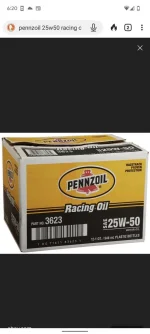

A sleeper oil with little to no VII is Pennzoil 25w50 racing oil.
Not too expensive and should work well in that engine.
