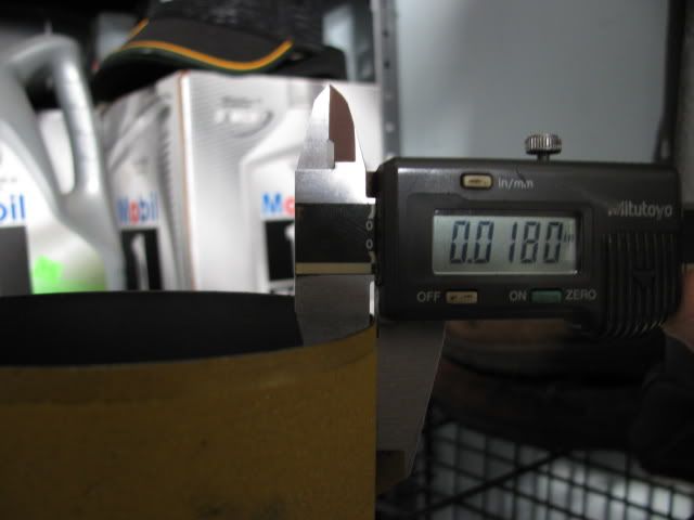

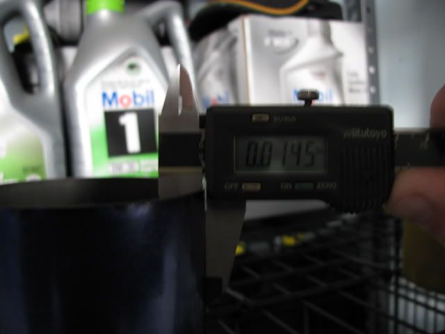

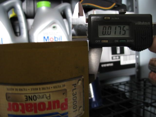

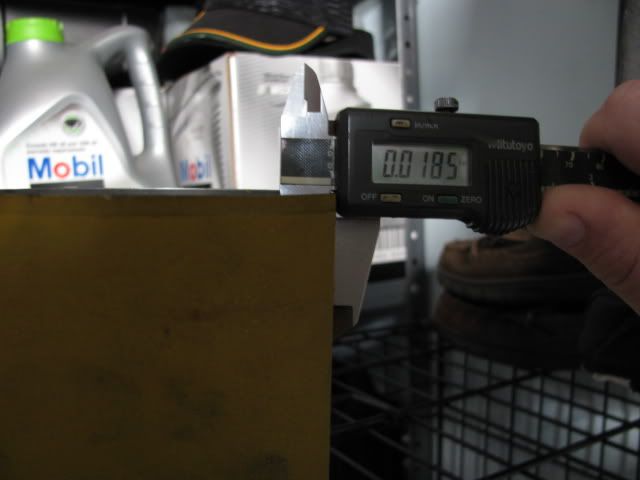

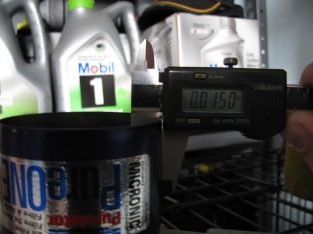

Yep i've been working on it but with Christmas shopping/holidays it's been slow going,still working on it but here is a comparison of the two Purolators new and old style and there FAR from a pop can,very sturdy filters...
old style...
new style...
as you can see the new yellow P1's are a thicker walled can,no concern here..i'll be doing more measurements soon stay tuned...

The P1 is thinner than Wix (.020" according to Wix), and Toyota Japan, that I measured at .020"(rounded off.) I don't think it is significant, but % wise it is quite a bit thinner. I measured a pop can and it is 4 mils, .004". On a large filter it is easier to squeeze it in by hand than a smaller, so it feels flimsier.

I said the Wix is .020" thick, by their website, and I measured about the same on the Japan made Toyota can. My measuring tool is very accurate, as is my use of it. Your pics show P1 from about .015"-.018". So the .015 is about 25% thinner than the Wix or Toyota Japan .020. Burst strength would also depend on the kind of steel used I suspect.
