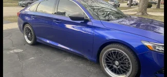

What might help is a Pic of your car and then I can tell you if you would benefit from the Fram Racing Filter!
Here.
2020 Accord 2.0t upgraded turbo, full exhaust, tuned on flex fuel/e85 estimated power is 400 horsepower and 400 torque. Tires are 255/35/19 if I punch it from 40-45 mph when merging onto the highway I break the tires loose. It’s a fun car. I’m waiting for the track to open up soon hopefully I’ll be in the 12s somewhere.

Amazing, if this were a V8, we would be talking about 800 Horsepower, how many quarts of oil does this engine hold? Another question, how much does your car weigh?

It’s not too bad. I need to keep the horsepower modest on mine because it also doubles as a daily driver. The new bolt on turbos that just came out are making north of 500 horsepower (rated for over 600) a few Civic Type R’s are pushing around 600 horsepower on factory bottom ends. With a sleeved block we will begin seeing 1000 horsepower cars on these platforms soon. JSR engines sleeves these blocks for cheap. Hondas have made 1200-1300 horsepower on sleeved blocks. After that you need a billet block. Speed Factory’s Honda makes 2000 horsepower (without nitrous) it ran a 6.91 @ 198 mph lifting after a 1000 feet. On a full pass that should be a 6.7-6.8 second car. Sorry for going off topic lol.
