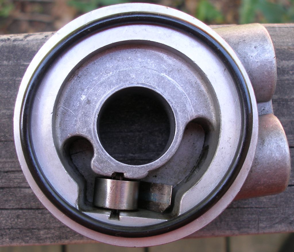

I already have a sandwich adapter, and it looks like this one.

Looking at the sandwich adapter, the middle arms that hold the outer block housing to the center ,the 4 chambers are totally open. Then that's where the 2 NPT 1/8" are tapped at the bottom of the block, My sandwich adapter is similar to this ,but mine has 3 tapped holes, I probably have to tap one more to install one of the sensors.
So lets say I install oil lines to the bottom of the sandwich adapter, then run them to the thermostatic block, then from thermostatic block to the oil cooler.
Lets say I attach the oil cooler directly to the sandwich adapter (no thermostatic block for now), since the sandwich adapter is "open" on the inside without any chambers, how would the oil move from one end of the cooler to the other? Wouldn't the oil just stagnate in between the sandwich adapter, because their pressures are equal ? Am I missing something here?

That adapter is not the type you would use. As you noted, all its ports are "out". It requires a separate return path. Mostly those are used to add gauges or supply oil to turbos which then dump the outlet oil back to the pan through another route.
