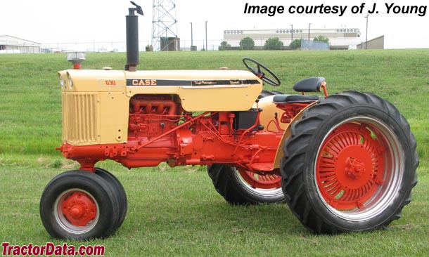

This isn't a picture of mine, but here's one just like it. Dad thinks ours is a 1962. Grandpa bought it new.
