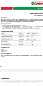

My case is i have a car, well both my cars in fact recommend Monograde SAE 80W GL-4 gear oils for their gearboxes.
Up until recently i was still able to locally source one Castrol made which i currently have in both and works just fine, but i like changing MTF's at 5 year intervals maximum, thankfully on both it's possible as they have drain and fill plugs.
But i am looking at what to use next, i've been looking at 75W-80 but most have a somewhat thinner Kv100 than the 80 Mono and the Kv40 on all of them seems way lower and i am worried they may cause problems, what do you think?
Then also the Capri requires an EP90 Hypoid oil for the diff, which is also hard to find, i've been looking at 80W-90 or 85W-90 for the next change.
Redline is a bit out of the question, here in Spain it's just too expensive to justify.
....both my cars in fact recommend Monograde SAE 80W GL-4 gear oils for their gearboxes.
Lower KV40 is never gonna be an issue (as cold oil is thick anyway). Lower KV100 potentially is.
With KV100 at 9.9 mm²/s(cSt) you could easily replace Castrol Manual EP80 with a synthetic GL-4 75W-85 or 75W-90. Castrol Syntrans Multivehicle 75W-90 GL-4 comes to mind. There's also a 75W-85 brother but it isn't available in 1 l bottles. Both are thinner at 40°C (and more so below), though thicker at 100°C. At operating temp most of the time they're likely similar in viscosity to Castrol Manual EP80. Castrol Syntrans Multivehicle 75W-90 GL-4 is fairly comparable to Redline MT90 in base oil quality but much cheaper in Europe.
