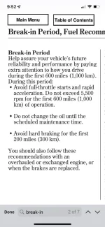

Only break in instructions from owners manual is the following.
