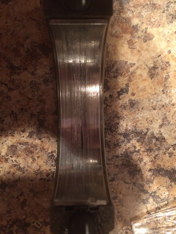

Pulled the windage tray off and still have ferrous metal and gold flakes in the pan, not as bad as the first oil change after the knocking sound started but still not good considering I RTV'd magnets all over the pan bottom before changing oil.
Can't see anything visibly wrong so the next step unfortunately is to pull each conrod cap to inspect the bearings.
[Linked Image]
From the sound of it the whole bottom end is shot. I can grab the rod caps by hand and wiggle it enough to get a good metallic click and visually see them move. Back to plan A.
Originally Posted by MarkM66
Bearing look bad. How does the journal look?
Where did all this contamination come from?
That sort of damage is common after engine work when a Scotch-Brite pad was used on a whiz wheel for cleaning the block during HG replacement for example.
Not saying that's the case but if one was used its a real possibility. Scotch-Brite around open engines = disaster.
The whole thing is [censored]. The journals have score marks too and the bearing was stuck to the crank. Had to push up on the rod and pop it off. Filter was on so tight I tried a claw wrench which tore some pin holes in the filter without loosening it much, my other wrenches didn't fair much better so I cut it off and wiped the mounting surfaces clean before installing new oil and filter.
The pinholes caused leakswhich ended with a low oil light prior to me cutting it off. Only went about 200 miles between fresh oil and new filter before the knocking started.
I'm assuming due to the damage and path of oil after getting sucked into the pickup the cam bearings are shot as well. Probably just gonna swap blocks, the price of specialty tools needed to pull the balancer, install the rods and pistons and possibly hone the cylinders equates to a crate engine.

It was metal from filter that caused it. The amount of metal shed was unbelievable. My oil catch pan had glitter swirls in top of the oil.
If there was that much metal in the filter in the first place, wasn't there an underlying mechanical issue that was the root problem?
