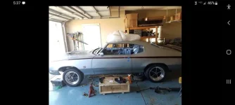

Got any pics of the engine/car? 😃
Here is the car which is not finished. And the engine from last go round.
