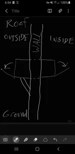

I've been brainstorming an unusual lock box setup for my shop. I have concrete block walls and I have an old unusable swamp cooler that I've been wanting to remove for years now. I recently realized I NEED a bin/box/shed/something to allow the delivery drivers to secure my parts in (mainly weather reasons). I'd like to remove my swamp cooler and put a double-sided 'drop box' in the empty hole. The best comparison I can make is to a large window A/C unit, but with the guts removed. I just don't know what is available or how to go about it. I made a few 5-minute sketches of the basic concept I'm after. I want a locking external hatch door, and a door (not sure yet if locking or not) for the inside as well. I want it to take up the entire wall hole if possible, but I need to take measurements. I want the doors to basically take the entire height and width of the box, because I need to fit large items through the doors such as large brake rotors, jugs of motor oil, 50lb bags of Oil Dri, etc. Any ideas besides finding a local welder and paying for custom creativity? Any help or advice is appreciated. Here's the quick sketches:

You need a large pass-through.
One end is free to open so deliveries can be dropped off anytime, I assume.
The inside door locks from the inside so people cannot enter.
Your drawings show a hole already in the wall -where the swamp cooler is now?- .
Is the above correct?
What are the holes dimensions? How far off the ground is this hole? Once the swamp cooler is removed, can the size of the hole be changed?
Yes. Exactly.
What is a swamp cooler?
Dimensions I'm not sure about yet, haven't had time to measure. I promise I will ASAP, but I'm taking a trip this week out-of-state. As far as changing the size...not easily. The hole is through a concrete block wall. A swamp cooler as it is commonly called here, is an evaporative cooler. Mine is basically an older, beat-up, non-working version of this.

Yes, the hole in the wall is off the ground rather high. If standing in my shop, the hole is about waist level, maybe slightly lower. But if standing outside, the hole is about chest to shoulder level. The ground outside is probably 2-3 feet lower than my shop floor.
What would be the purpose of cutting the backs out? Not being critical, I'm genuinely curious. I can't picture why that would be needed. Unless maybe you're talking about using a job box in the hole in the wall? Yeah, I think that's where you're going with it.
