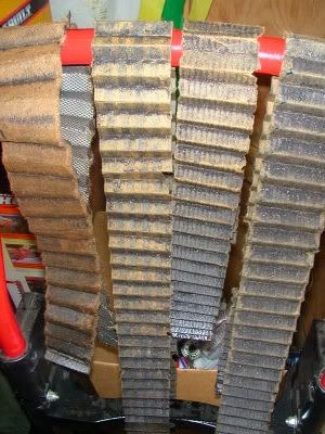

Well, here we are. Results of 2 cycles or auto-rx on my 2001 Saab 9-5 2.3l turbo. I acquired the car w/ 59,000 miles on November 5. I was extremely panicked b/c of these cars' reputations as sludgers. There was a nice coat of varnish on the dipstick. When the valve cover was removed, there were scattered pockets of small amounts of sludge in cracks and crevices. I began arx at 61k I believe. Lots of crud in the filters.
The first clean phase filter is a Fram. I can't remember which but it's the big beefy one that looks like it means business. The oil was M1EP 5W30.
The second filter (1st rinse phase) is a Purolator PureOne. LOT'S of pleats. The oil was Supertech 5W30 dino.
The third filter (2nd clean phase) is a Purolator PurePlus. Not as many pleats. The oil was Castrol Tection Extra 15W40.
The fourth filter (2nd rinse phase) is a Supertech. About as pleated as the PureOne. The oil was once again Castrol Tection Extra 15W40.
Notice that the rinse phase filters seem to have more crud than their preceeding clean filters. We've always heard that the real action takes place in the rinse phase. I don't know WHY the 1st clean filter looks so clean but the others made up for it. Though under the valve cover, some bits o' sludge remain, these filters don't lie. Stuff got cleaned up quite a bit.

Great visual documentation.
I'd guess that the first filter (initial clean phase) looks cleaner because synthetic oil was in use - along with the fact that more "crud" shows up during rinse, typically.
Lol, I just noticed. If you look at the 2nd of the group shot of filters, below the 3rd filter, you can see an old bottle of B-12 (flushed the mom-in-law's Yukon, lol) and part of one of the filter housings in the trash.

I thought one of the benefits of ARX is that sludge /cruds will be washed away slowly, instead of in solids. But look at the pictures, it appears that they are fairly large (in grain size?). Is this expected?
It wasn't too big. I found one chunk maybe half the size of an English pea. The rest were small. That's the reason for the upclose shots. I couldn't tell what they were. You have to understand, this isn't just your traditional sludge, this is also turbo coked oil. I suspect there was a whole lot of debris buildup in the oil pan. These cars are know for clogging oil screens if not properly taken care of.

Thank you very much.
Yes, they've been hanging for a while just like that. All I did was group them together for the shot. The oil dripped off (well, some of it is STILL dripping) and all that was left was the crud. The only shot with a fresh filter is the one on the shop towel.
