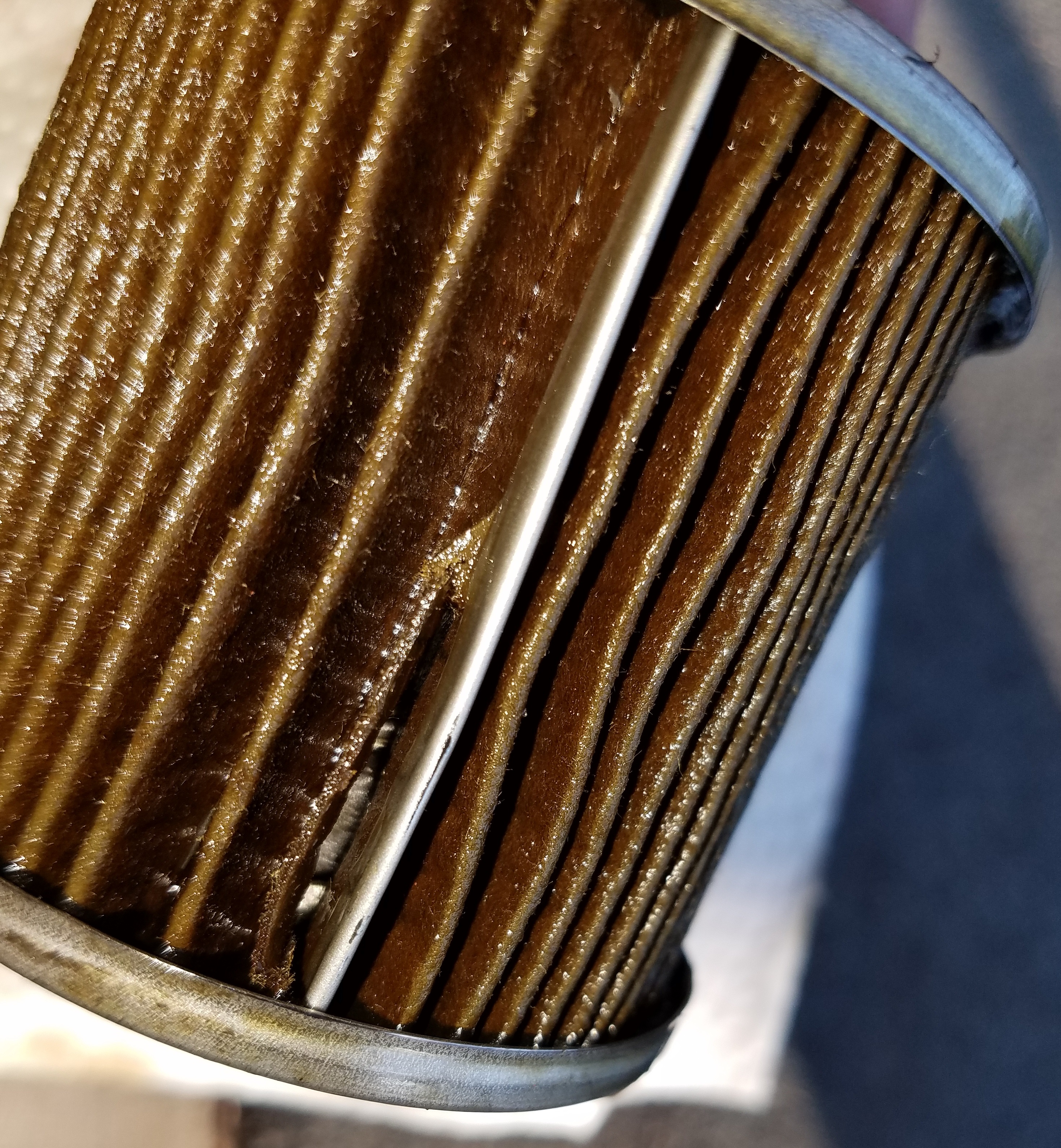

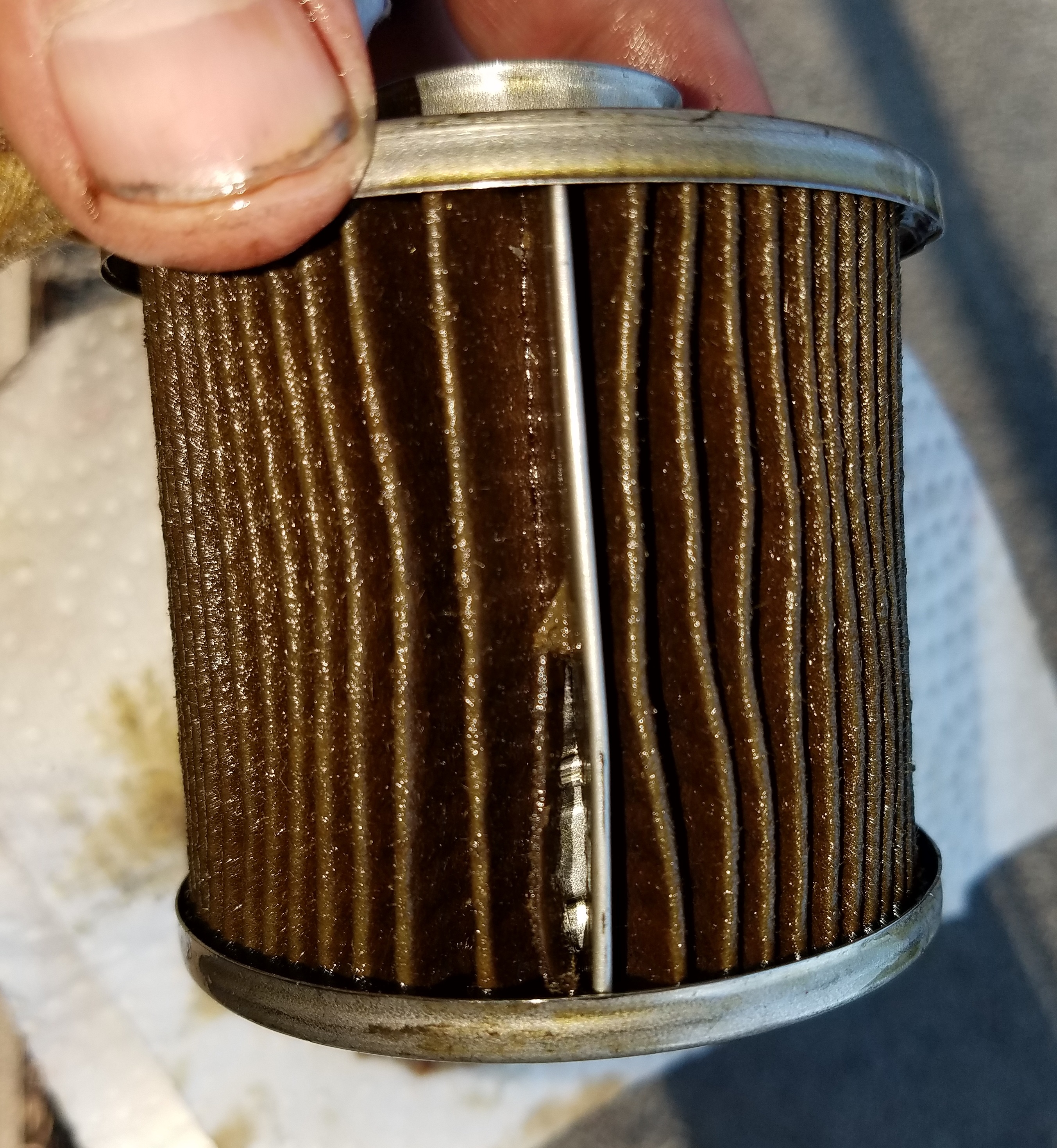

Wife's 2017 Jeep Renegade finally got to 3K miles last week and decided to do an oil/filter change on the factory fill. Removed the factory installed Purolator made MOPAR 04892339AA oil filter and found the media torn or what really looks like a bad crimp on the two halves. Either way, Purolator cannot even get the OEM filters right. I am totally done with Purolator and their junk. That company really needs to get their head out of their rear end.
Ouch. "Factory Installed" ... maybe Jeep would like to know about it. This failure looks like the seam wasn't sealed up right, not a media tear failure.
Thanks for c&p sir
Purolator quality SUCKS!! Im taking back the P1 i bought for a friends toyota now. Purolatoe is a royal joke and charlie foxtrot!
Yeah, I am leaning on a improper crimp here also. I will call my dealership service adviser tomorrow that I am tight with and see what he says. Not expecting much as I am sure the Catch 22 of me opening it first will play into deniability or taking responsibility.

Where is the tearing, only see a pleat not crimped into the connector. It looks strictly a one off assembly defect to me. Same bad QC like has been seen on some other brands lately.
Originally Posted By: Hootbro
...Yeah, I am leaning on a improper crimp here also.....
That's what it looks like to me. Assembly line error, not classic tear with use. There's a much viewed youtube of another brand with a similar defect.
