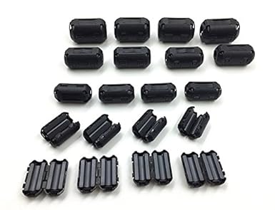

Also put ferrite noise filters on all the cords leading to the router and actually any electronic device I have. This is simple to do and cheap they clip right on the cords. If you do a search you will see what I mean

Below is the ferrite noise filters I was speaking of, I came to realize they do work but on a different application. I was having a problem with 2 touch screen wireless alarm system keypads ( in my own house no less) not working reliably, signal was low, yet pretty darn close to the central unit, for the heck of it one day, I clipped these things on the power lines feeding the keypads, signal went up to all the max bars on the display. Never looked back, never an issue again.
I noticed TV makers put them on their power cords, I noticed camera makers DLSR have them on their data cables and I noticed some good quality HDMI cables have them as well. Figured there must be a reason and I found one reason in the alarm system, so now, every electronic device in my home has them, as well as every CAT 5 cable and anything to do with computers.
They are so cheap, most times just ordered off ebay or wherever, bought every size imaginable.
All I know, is my wifi network never goes down, never needs resetting, I also have them on my wifes work computer, that is using its own router with a VPN which is plugged into a powerline adapter which is plugged into the back of our router and goes to her office in another state, her office phone also runs off of it, been rock solid reliable. Im a bit extreme and I also pulled the outlet that the powerline adapter is plugged into and placed the noise filters on the 110 line that feeds the outlet. Always has a solid great signal light.
