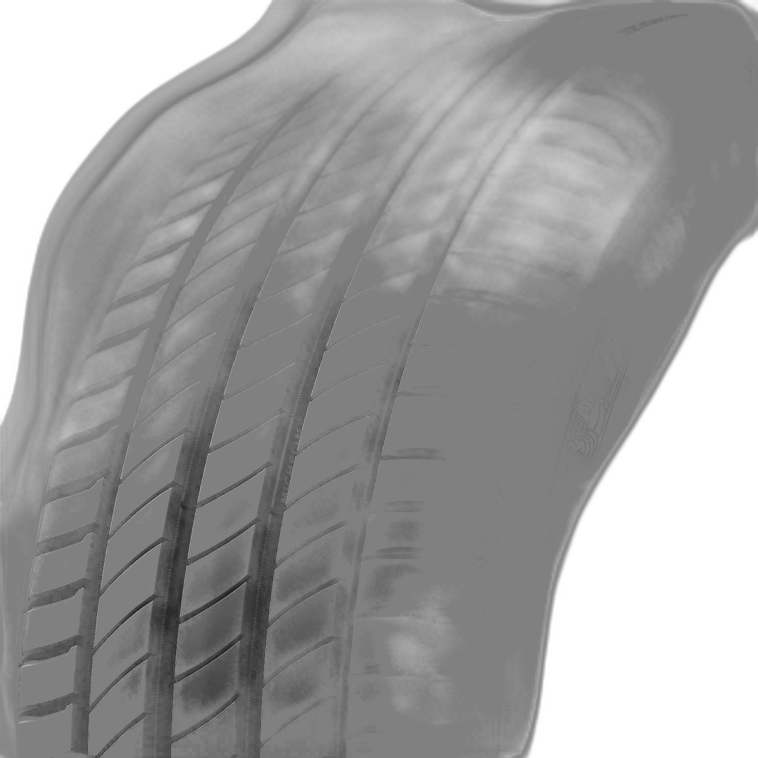

But how is it possible that this Michelin is quoted as one of the most silent tyres and it still has lots of cross tread?

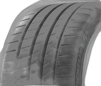

And before I have had this Pilot super "sport" and this was a TERRIBLE tyre.... I heard the sound of a binging basketball ALL the time!!! Even on a pretty straight nice road..... I lost lots of money on that set.... When they tried to sell me the Dunlop sportmax with NST (foam) I almost got an anxiety attack because of the word "sport" written on that tyre!
How is it possible that this Supersport is so loud with less thread?
Michelin Pilot Super Sport ️ 245/35 R20 - Beoordelingen en tests 2021 - Autobandentest.eu
no not at all. Slicks are very noisy. But uniform sized thread blocks, especially on the outer rib are noisy aswell
I never knew this! I thought. No ribs, no sound but it seems to be the opposite.
Do you mean with uniform, a straigh line or stripe? Because both of the Michelins above have a line but the Primacy is a bit curved and the Supersport is more straight.
primacy changes the width of the thread blocks so the noise cancels out, it reduces the humming you get from the thread. The dunlop does that too

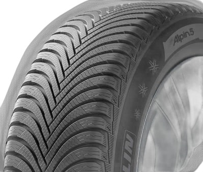

Is that also the reason why my beloved Michelin Alpin 5 tyres are so silent??
I love these tryes so much. I have them on another Lexus in 225-55-16 but next set ill be taking 225-65-16 for even more comfort.
