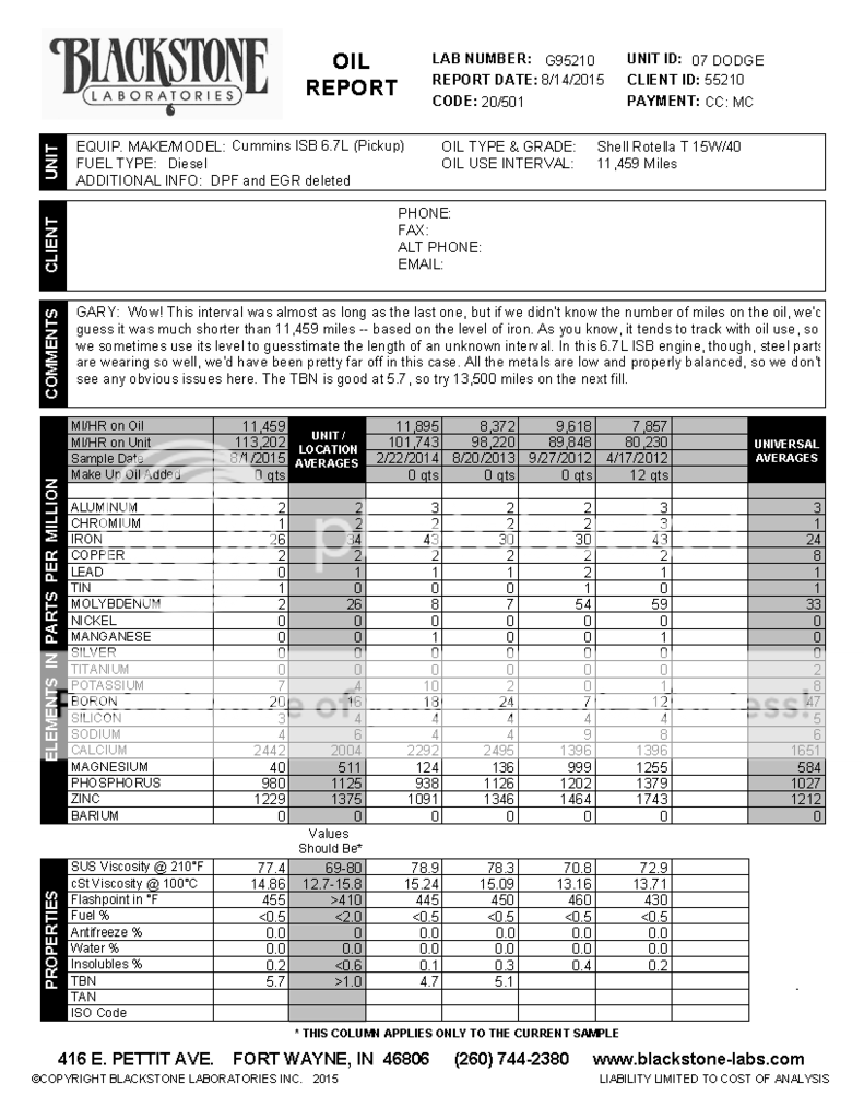

Here's the latest test results. The first oil was Mag 1, then Halvoline and the last three were with Rotella T. All but the last one had heavy loads towed with a GCVW of ~25000#. Since my wife no longer competes we sold the big trailer so it's easy pulling now and not very often. The last sample were the results of mostly pulling a 5000# bumper pull horse trailer. I would have gone further with the oil but it'd been in there for almost 18 months and the truck is always outside in the humid south. Measured the oil as it comes out and it doesn't burn any oil. I consider the results very good and think I could have gone much further. The truck is now 8 years old. I'm now to the point where Dave is...the tires will not wear out but go rotten before a couple more oil changes!
Let's consider this a poll, how much further should I push it next time? I'll be the guinea pig....well, to a point...
Hey GBL, that looks great for sure. Don't worry about being a guinea pig but if no problems pop up, I think 20K would be a piece of cake.
Based on your sample results, I'd test somewhere along the way. What ever your comfortable with, but maybe half way to what you think you're willing to run an oci...or maybe annually. Just some ideas. That engine is going easy on the oil, for sure.
I ran Rotella TP last year and was impressed with the TBN retention and had great results with it. Thanks for posting!
