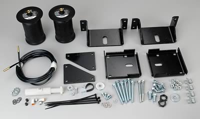

I also installed an Air Lift 1000 Load Assist rear spring kit, for when I carry extra weight or I want the rear extra firm. The only down side is that you have to top up the pressure, every couple of weeks, to keep a minimum of 10lbs in them. If you don't they wil wear out prematurely. I am getting their on board pump with pressure sensors soon.
I really like the results I got using this lowering method. Handling, especially cornering, has greatly improved, and appearance has also improved quite a bit.
