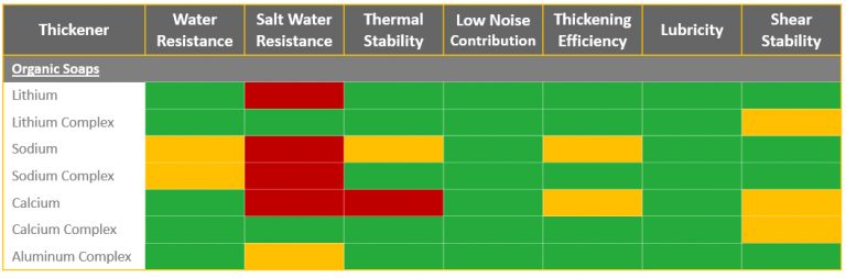

Looking for an all purpose grease, why the heck are there so many types of grease I'm lost.
alu and li greases have been recommended, exercise caution when replacing these.
https://penriteoil.com.au/knowledge...ility/116/what-types-of-greases-are-there/322
