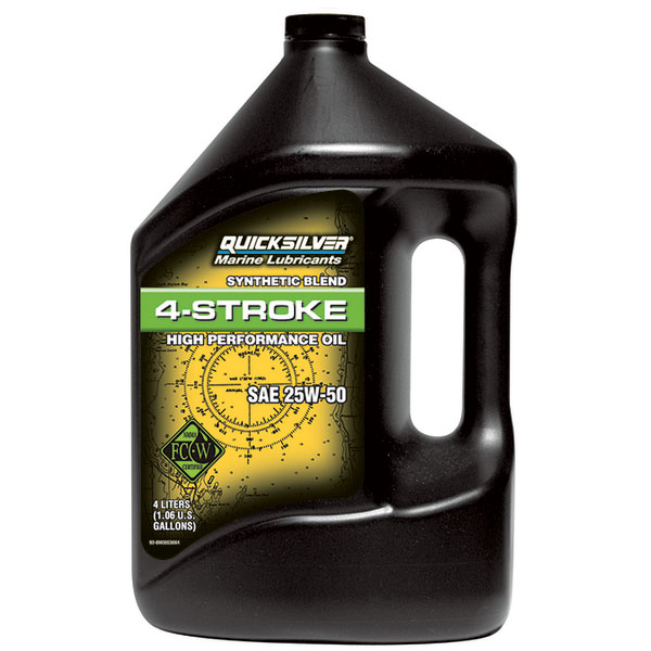

Merc/Quicksilver also sell a 25/50 syn blend that was formulated for the Verado supercharged outboard and race engines, in your very hot ambient climate that's what I'd use, in fact I started using it in my old Chevy 4.3. It is very expensive but is probably one of the best OEM oils for a high performance marine engine. Alternatively you could use Valvoline VR-1 20/50.
keep in mind that the Mercruiser and Quicksilver products are identical, the difference in labeling is that Merc dealers have to sell the Merc labeled product whereas the Quicksilver product is most often sold elsewhere, including Amazon, I also found it a West Marine.
