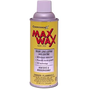

Corrosion X makes a product called Max-Wax. It's about the most effective product I've found. AV30 is another product that is exceptional, however, it is exceedingly expensive.
http://www.corrosionx.com/max-wax.html
I use it extensively. I find that the use of 3 heatlamps to heat the surface prior to application really makes it flow into the seams.
[Linked Image]
Here is a picture of AV30, applied with a heat lamp. Notice that it wicks to the other side of the seams. I applied it with a paint brush. The MaxWax will do exactly the same if the surface is warm.
http://[URL="http://www.corrosionx.com/"]www.corrosionx.com/max-wax.html[/URL]
Does MaxWax have a lasting smell? Looks to be a good product but don't want a bad odor fest around my truck. I don't mind a smell while spraying. I do like the fact that it has VCI but usually the trade off is funky stench.
[Linked Image]
[Linked Image]
That stuff is almost 300$ per gallon!!
