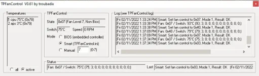

There were a couple of casualties. Two screws that did not make it back into the laptop, and are still on my desk. That's not that big a deal---but I broke a clip holding one of my 8 gig sticks of RAM, so now I'm back to stock 8 gigs of ram, which doesn't appear to make that much of a difference. And now the fan utility has me at 48C instead of 70-80 like it did before. Speccy has me at 94-97C, instead of the 140C that it was measuring. So whichever one is right, cleaning out the fan sure seems to have made a big difference.

Uh oh, just happened again. I rebooted and the fan utility has the temp at 54C. So perhaps cleaning out the fan problem made it better, but didn't eliminate it?

54C is definitely not too hot, so while you've solved the dust problem, it seems something else is in play here. Can you make up the UBCD and run Memtest? Wonder if that stick is flaky? You could swap it with the other one.
When I put my ear close to where I usually hear the fan, I can hear at least what I think the fan is, running at the lowest volume. But it is absolutely not the loud level that I've heard in the past.
the fan motor is broken (any noises?) or system for some reason is not giving proper speed signal to it.
