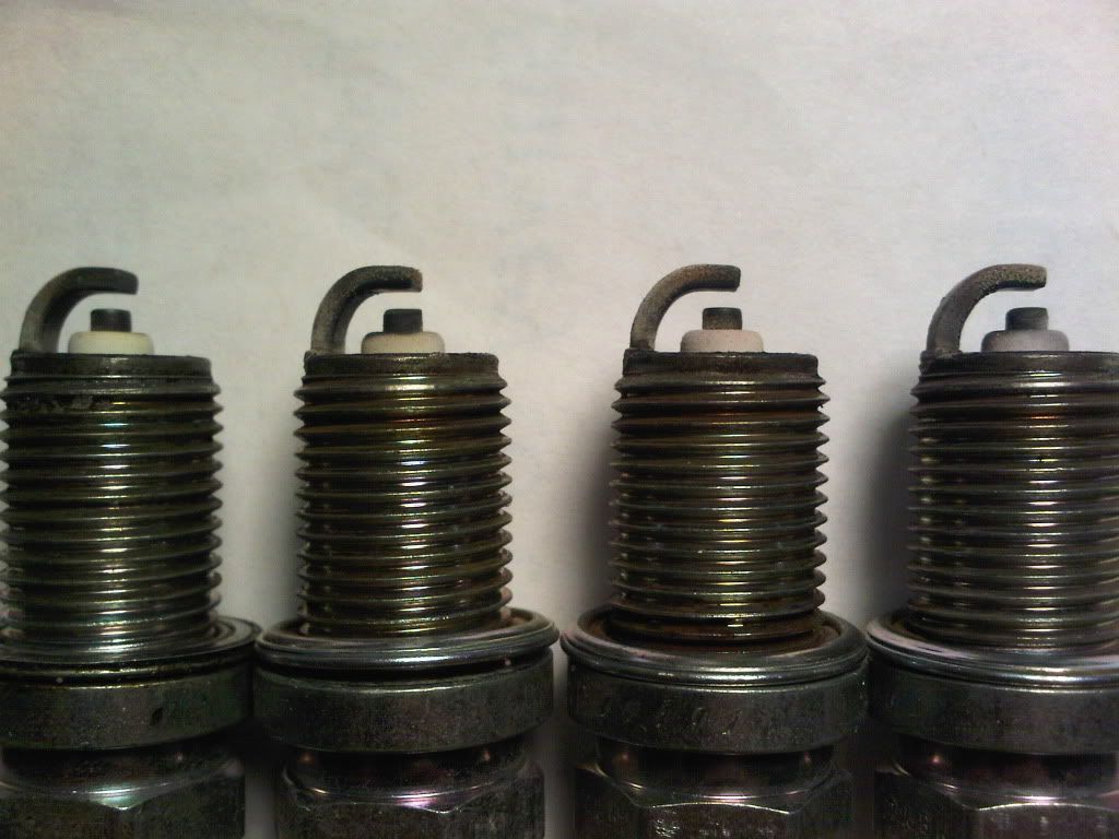

The car runs so much smoother. However, it definitely feels like the engine does not "pull" as hard, yet the engine runs noticeably smoother. The new plugs are the Bosch Super Plus copper plugs with a yttrium-enhanced center electrode.
The old plugs were NGK coppers with about 20,000 miles on them. All of the center electrodes were black, though the one from cylinder #4 looks a bit more gray than black. The plug from cylinder #4 shows some serious wear on the center electrode.

What do you folks think of the old spark plugs? Do they look normal? Are the center electrodes supposed to be black? I have been having issues with the car delivering poor fuel economy, so I am hoping new plugs solved the problem.

Those plugs look fine. Old design and gave good service. What you are calling very worn is barely worn. I have seen some really worn plugs that did not even misfire. Both electrodes worn to nubs with greater than .080 gap, but still working fine due to a high energy ignition system.
As far as color, yours are normal as well. If you were to take it on a hot interstate run and then just pull over and pull the plugs, you would most likely find a much lighter color on the center electrode. This is normal.

I agree, they look normal.. for 20kmiles.

IMO they look normal and should be left in service after a light cleaning and a tiny dab of anti-seize. It also looks like cylinder #4 runs a bit richer that the other 3. Maybe that's where your Valvoline 5w30 is going.

Old plugs could have stayed in for another 50,000 miles.

My plugs look much worse at 20,000 miles, but I burn a lot more oil in my Saturn. It will be interesting to see how the Bosch plugs work long term with the waste spark ignition system. I have been told the center electrode on some plugs wears quickly and misfire follows due to the design of the ignition system on S-Series. One reason I stick with OEM NGK plugs.
The old plugs look fine to me. I also would have left them in service after cleaning them. By the way , those Bosches are about the only Bosch plug I would use. I might give the single Bosch Platinums a try (in certain engines) because I had good luck with them 20 years ago but I wouldn't use the Bosch 2 or 4 plugs. I think they are a gimmick.

I have a dial up, so multiple massive pictures take forever to load. What I can see are near perfect old plugs.
20k with plain steel plug in this condition is remarkable.

I normally see plugs coming out of a 4 banger to be much "whiter" than this, and think Cyl 1 is actually running richer than normal. Cyl 2 is blury but 3 & 4 seems ok.
Michael, when taking picture next time, shoot from the tip so we can see the insulator's condition as well. I think I notice #2 has some black deposit on the insulator.
