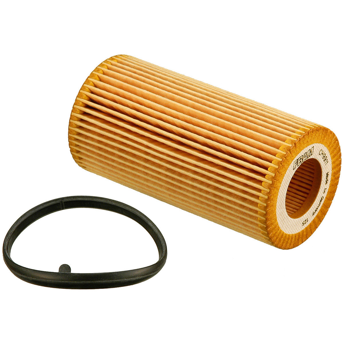

Back when I had my 08 Passat, I used Fram CH9911 cartridge filters
The original ones where Made in Germany filters, that fit perfectly in the oil filter housing. But when Fram stopped selling German made filters and went with a different endcap design and manufacturing location... they were a little more difficult to get the filter housing back in, which I suspect was a slight length issue, which upon removal, the filters ended up wavy. Back to Mann I went and never had issues to trading in the car.
