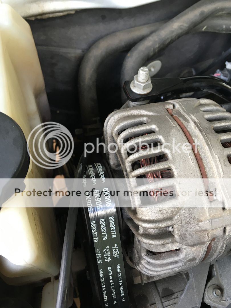

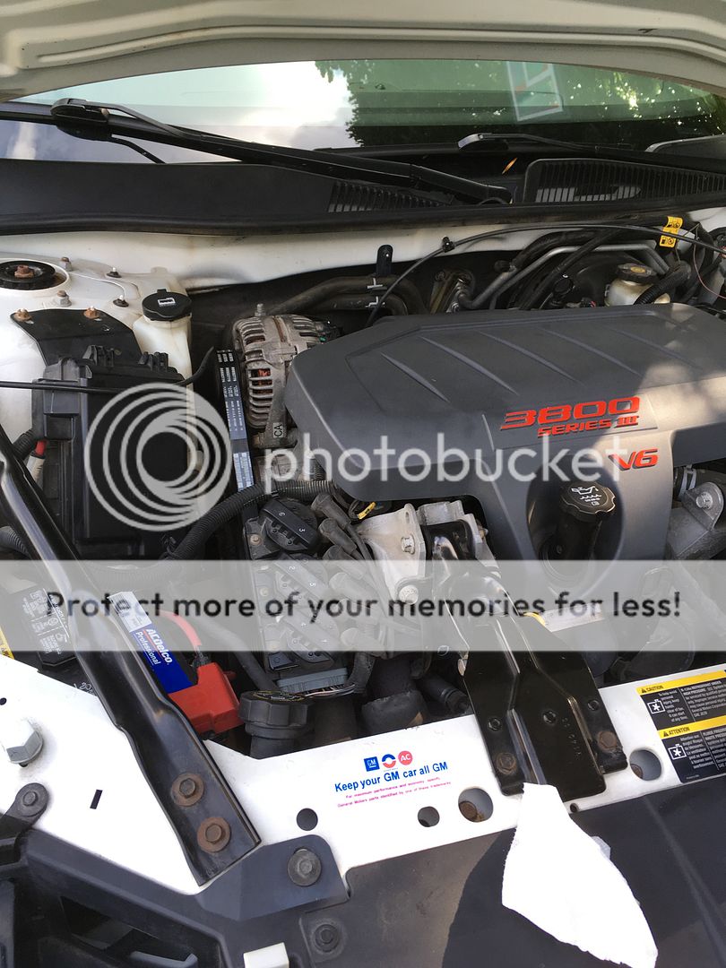

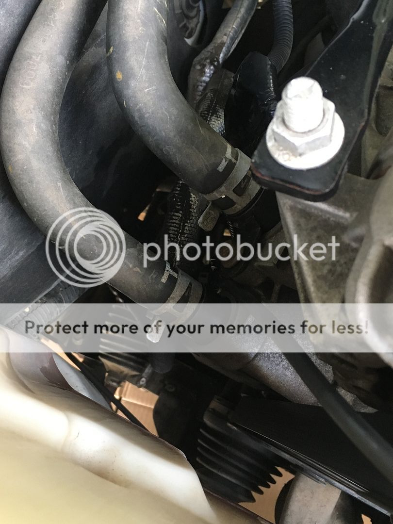

Hey everybody. Just wanted to share how I changed my power steering fluid. I bought 2 quarts of (very expensive, $25 a quart) AC Delco COLD CLIMATE power steering fluid (a synthetic blend formulated for low temperatures) from the GM dealer. It was actually the same price there as on Amazon. I warmed up the car, then opened the power steering reservoir. (NOTE: On W-bodies, the power steering fluid reservoir is buried behind the alternator). I took my siphon pump's small black tubing and sucked out the old fluid (only about 5-6 ounces). Then I refilled with my homemade turkey baster extended funnel. I checked the level, capped it off and drove around for a few minutes, taking a route with many turns. I also tried to turn it lock to lock. Then I drove home and repeated the process. I did it 8 or 9 times, over a period of several days. At first, I tried to suck fluid out with the turkey baster but made a huge mess. And even with the siphon pump I still made a bit of a mess. It was pretty easy, other than burning my hand every time.
You can see the black hose behind the serpentine belt here.

Another view,
