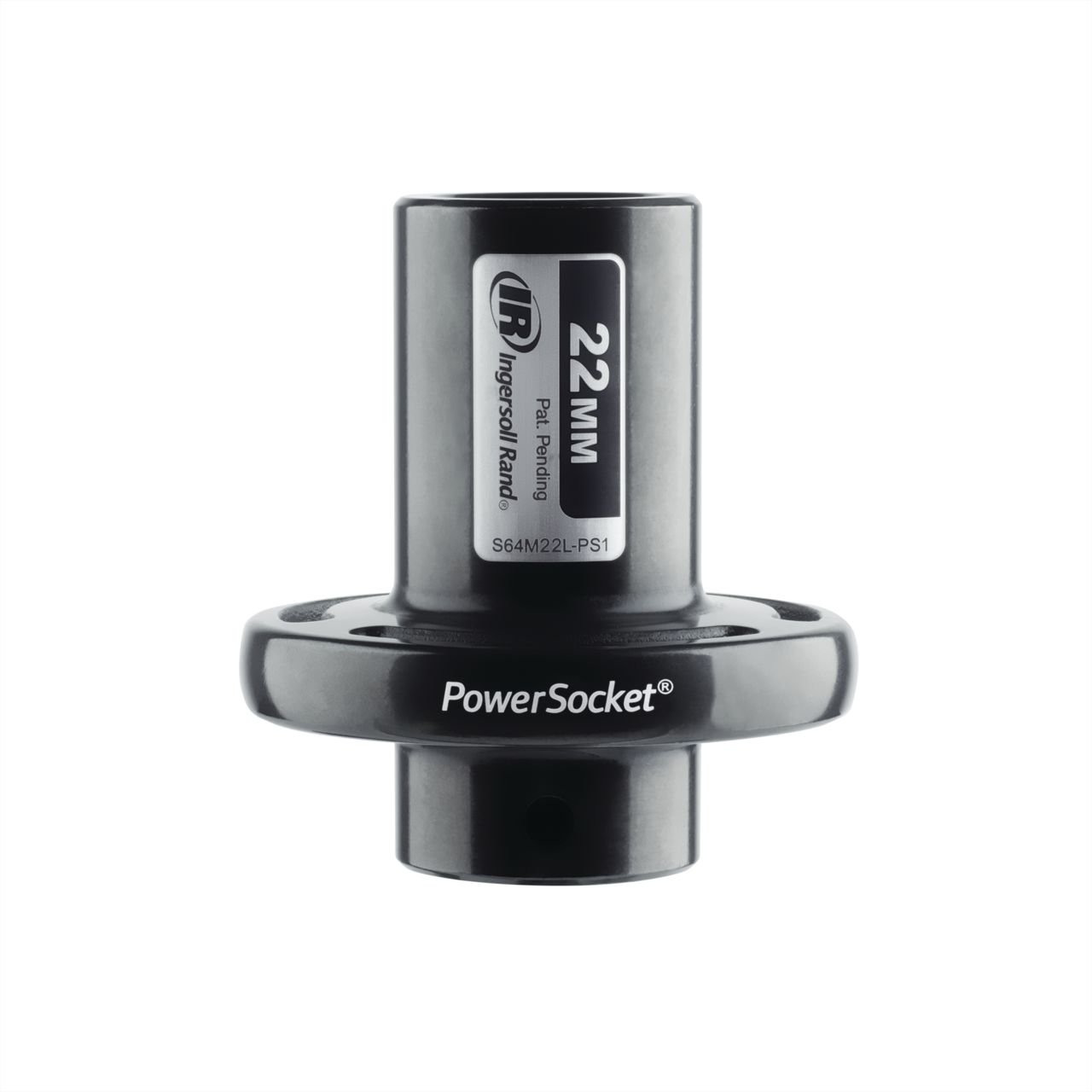

If I didn't have that I'd get one of their Power Sockets.
