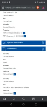

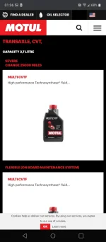

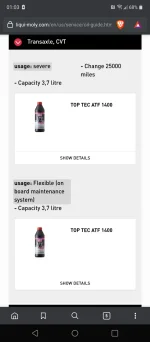

Severe operation capped at 25,000 by Fuchs,Motul and Liquimoly for CVT Transmission fluid maintenance.
