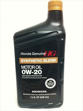

Philips 66 Synthetic Blend:
The new Philips 66 bottles have sharper corners with "strakes". These started appearing in spring 2011, there may be some labeled as API SM, but most are API SN. The blend comes in black bottles in 0w20 and other weights.
