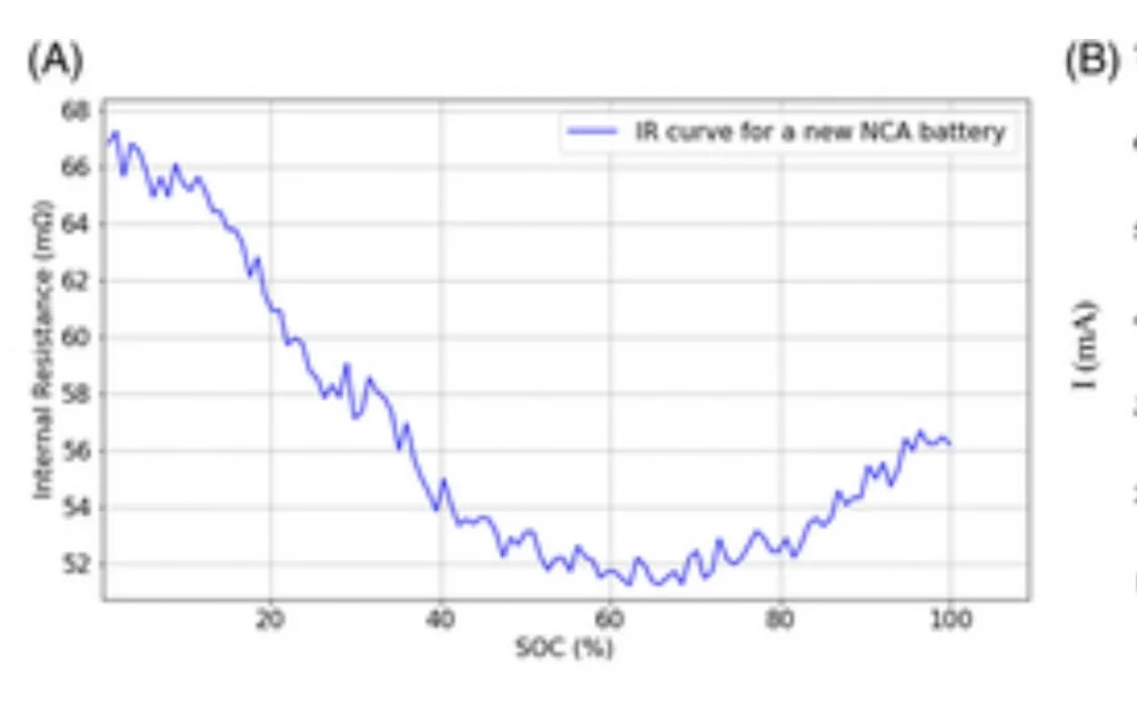

3) favors lower current as in cell losses and heating are also I^2 *R. There are activation losses that drive the need for over potential, and aso it may be U-shaped.
Example of an impedance curve for NCA cells:
So there can be a greater than 10% difference in ohmic losses based just on what the starting and ending SOC is.

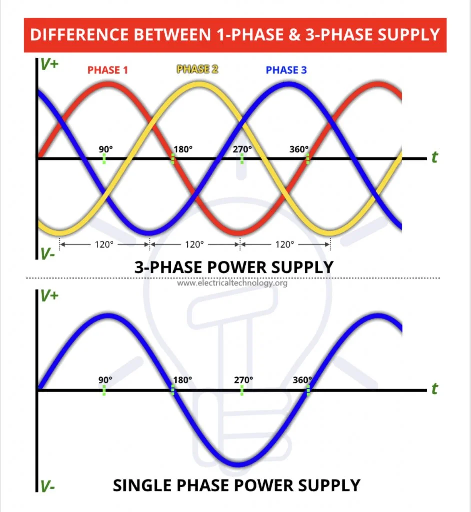

There are a variety of benefits associated with three (or polyphase) power. Some are related to motor and magnetic design, but the main benefit for charging systems is the ability to carry more power on fewer/less conductor, and provide cleaner dc with less ripple.
Here’s an example of split phase (single phase) vs three phase. Recall that AC power is sinusoidal in voltage and current.
Rectifying dc is the process of taking the alternating (AC) sinusoid, and making it into direct current which for the sake of this, is only positive offset. Rectification of single and three phase looks like this:
Note how bad the ripple is for the single rectified phase. Three phase overlays all the ripples and has significantly less. It’s “cleaner”. There can be polyphase rectifiers that are fed via phase shifting transformers to be even cleaner. Ripple is not good for batteries. I wouldn’t doubt that some larger charging stations might consider more phases.
Some examples:
In the end, the more phases/pulses, the cleaner the dc waveform, the easier to filter and smooth, the better it is for batteries and other equipment. Ultimately it’s a balance of cost, power quality, harmonics, size, efficiency, etc.
Some examples:
