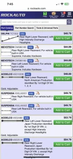

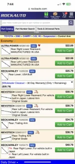

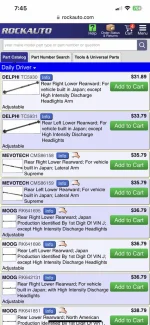

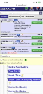

RA shows a bunch of brands (including Beck Arnley). I can get OEM Toyota but I don’t wish to pay $300 for the pair (that’s with the recent discount). I attached pics below:

I've had good luck with Beck Arnley sway bar links. Wow is that what Toyota wants?? sheesh.. a little pricey!
Yes Toyota is pricey! I was leaning towards Beck Arnley too but don’t know who or where the part origin will be 🤔
ya the ones I've gotten were taiwan made. guess inflation is finally hitting Toyota, for awhile their prices weren't going up.. I know when I was comparing other makes with the Beck Arnley ones, I liked how metal/rod wasn't thin and the ball joints moved smoothly but not flopping around.
